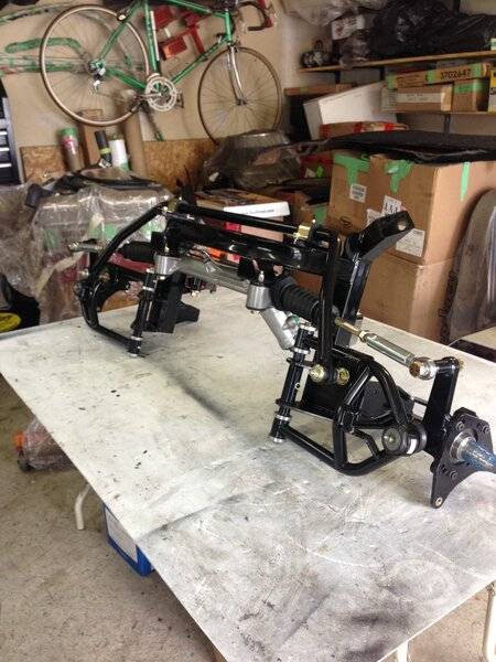

Now let’s discuss the HDK suspension. Right away, the adjustability of the lower control arm alone gets a checkmark in the win column over stock components. Just having this one component being adjustable allows track width adjustments, easier caster adjustments, and wheel base adjustments when running aggressive caster. Upper and lower screw in ball joints allow options to use a longer balls joint for dialing roll center adjustments or even opportunity to use non-traditional spindles. More on that later.
Just like almost all coil over conversion for Mopars, the HDK uses a Mustang 2 style spindle. There are many options available when it comes to the M2 spindle. There are inexpensive versions, there’s a Wilwood version that is approximately ½” taller than standard, then there’s a relatively new CPP option that uses the corvette hub and brake assembly. The options for brakes on these spindles seem endless. I chose to use the corvette hub style, mostly to get the much larger sealed bearing and a Wilwood 6 piston caliper. Every car guy wants options, the M2 spindle offers that and it works great for drag racers and cruisers. The biggest problem with the M2 spindle is its very short. HDK remediates some of the height problem by supplying a 1” taller than stock upper ball joint. However, this isn’t enough if you are looking for maximum handling capability. With the shorter spindle, the upper control arm has a downward angle toward the tire. When the suspension compresses, the UCA will push the top of the spindle outward until it gets to the level point before pulling the spindle back in. This results in camber loss. Not a recipe for great handling. The second problem with the UCA having a greater angle than the LCA, is the roll center is in the ground. The short M2 spindle puts a check into the negative column for the coil over conversion, but the good news is, there’s a way to fix this.
The Wilwood spindle will help a little, but it still isn’t tall enough. The first option is to get an even taller upper ball joint. There are several aftermarket ball joint manufacturers that make up to 1” taller ball joints. When it comes time to go beyond that, I was only able to find 2 manufacturers. Howe Racing makes a 1.5” taller and Allstar Performance has a 1.5” and 2” longer option. The pivot point for the UCA and LCA on the inboard side is approximately 12.5” apart. This means the distance between the ball joint pivots needs to be greater than 12.5” to have any chance of getting the control arms into a position that will have a favorable roll center.
In trying to continue using the M2 CPP spindle, I opted for the 2” longer upper ball joint. I was initially concerned about sacrificing strength, but it’s a strong piece. The shank diameter and threads are larger than the 1” longer piece but still has the 7 degree taper. Using the combination of the CPP M2 replacement spindle along with the 2” longer upper ball joint, and the standard lower ball joint supplied by HDK, the ball joint pivots are approximately 13” apart. This gets my roll center to approximately 2.5” above ground.
As of this writing, HDK has been made aware of the 2” longer ball joint and will likely supply it with the kit if requested.
During my quest to refine the geometry, I found Ride Tech is now offering a taller spindle with the corvette hub designed to be used on their Chevelle platform. Based on scaling some pictures found on the internet, it appears the spindle is approximately 2” taller than the standard Mustang 2 spindle. Considering the HDK uses screw in ball joints, even if the Chevelle spindle has a different ball joint taper than the M2, ball joints of the correct taper could be sourced. Like with most GM spindles, the steering arm bolts on. There seems to be endless options on length for this part, so dialing in steering angle would be another adjustable feature. Having a 2” taller spindle will allow use of the ¼”,1/2”,3/4”, and longer ball joints to dial in suspension geometry more precisely. I’m limited now since I’m using the 2” just to get the UCA past parallel.
For the guys that are educated in suspension geometry that state coil over conversion systems don’t have proper camber gain, well, I fixed that. With just the taller ball joint change, the standard HDK camber gain went from .7 degrees at 2” of compression to 1.8 degrees at 2” of compression. The factory suspension with an FMJ spindle is around 1.4 degrees based on an old Mopar Muscle Magazine article. Of course, ride height affects all these measurements so use these values at your own risk.
Back to the question at hand, can the HDK handle better than a T-bar setup? As of this writing, I’m going to say my car is handling better than it ever has. I’ll admit, I never took the time to dial in camber gain and roll center on the factory suspension, so perhaps there are some improvements I left on the table. Let’s just say it’s just as good and move on. The aftermarket doesn’t support our Mopars like other brands, so let’s just embrace the fact that there are companies out there willing to contribute to our brand.

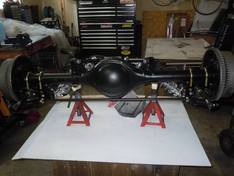

I have put approx. 6000 miles on my car since upgrading the suspension to a RMS Alterkation front and Streetlynx rear setup with Viking double adjustable shocks on each corner , 1.25" front sway bar, 7/8" rear sway bar. United frame rail connectors , front lower rad support, 4 torque boxes.
I have never autocrossed the car (no tracks here to do it) but I do drive it hard when I get the opportunity on very twisty roads outside the city.
I continually cruise with this Shelby.
Check the ride heights
He can get me in the straightaways (690 hp/6 speed) but I'm allover him in the corners.
Best performance mod I have done to my car to date!
To each his own but I'll never go back.

While I have no direct experience with the aftermarket systems, I trust those that have and the critics of both.
I don't see the advantage of these expensive conversions. The ones I've read from have stated that there was no measurable advantage of them on a race track other than a drag strip where access was improved for the oil pan and headers. Guys that turn corners don't pull their oil pans off 3 times a week nor do they change headers to run tip top at varying events where conditions change.
If the OP has found an actual improvement in the lap times of back to back events, that is hard data to support the value of the system.
I'd argue that these lack the long term durability of a stock based torsion bar system but nobody I know drives these cars 30,000 miles a year on bad roads so that may be a moot point.
I do see a difference in the K members that appears like it favors the stock system in terms of stiffness and durability.
The aftermarket stuff does look nice. It weighs less. If steering response is better, I can appreciate that but the Borgeson units I've installed don't have that center slop that even a fresh rebuilt Firm Feel unit has.
In short, the OP seems to have come closest to an even playing field for comparison of stock based versus aftermarket. For that, you have my respect and thanks.
