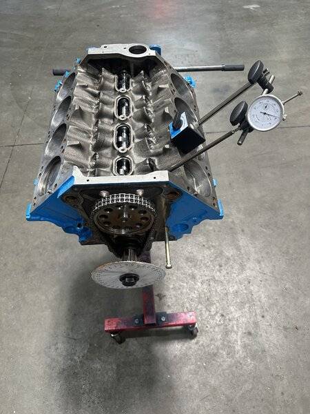

Here is how I degreed my cam. I don’t have a wheel but this worked really well. Just download a free LEVEL app and secure phone to the crank..
The question is, how do you know it's accurate? This IS A serious question. Did you construct some angles, and what did you use to do that?
