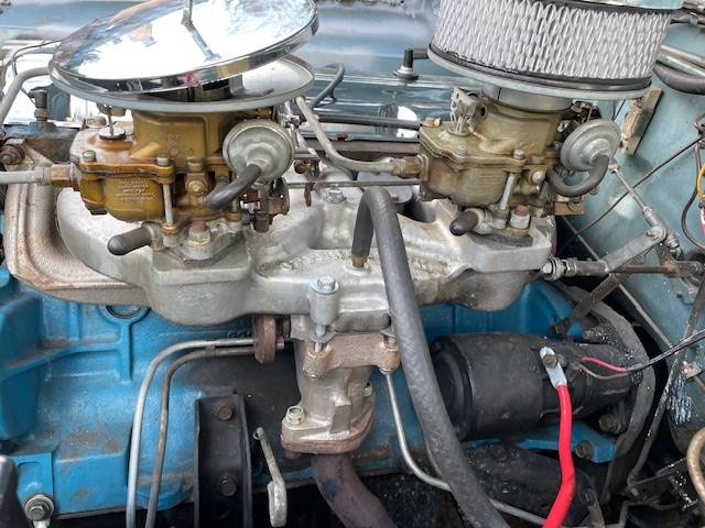

7) If your carbs
are off cars before the PCV system was invented, and they do not have PCV nipples then the throttles may have to be opened further than usual to provide adequate Idle-Air, and so, the intake may be getting too much air. IDK what I would do, probably I would drill holes in the Throttle valves, so I could synchronize the Transfers and the mixture screws. But honestly, I would sure like to install a PCV System, even if just a continuous idle bleed..
If both carbs have PCV nipples, I would splice them together and install a restrictor up near the PCV. This system has to discharge just underneath the Throttle valves, somewhere close to the fuel discharge ports. If you try to send it to just one or perhaps two intake runners, then you will have tuning issues.
8) Or perhaps your throttles are just TOO FAR open, and the transfers won't quit flowing.
Close the throttles until the transfers are just a hair shorter than wide, under the throttles. Reset the mixture screws as may be required, somewhere around 2 turns out.
