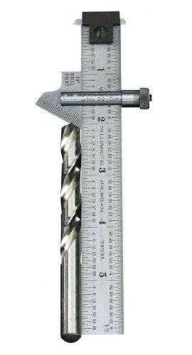

Bench grinder and drill point gauge.
I also use the fine stone on the bench grinder.
Doing it that way lets me make the bit cut how I want it to.
