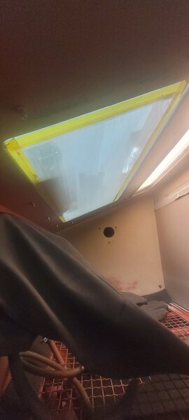

For the money, it is a decent unit but....
The window that you look through while blasting needs some sort of sacrificial plastic cover to keep the sand from hitting it.
Harbor Freight is quite happy to sell you a new sandblaster but they don't stock those small sheets of plastic. It looks like they are approximately 12" x 24". The blast cabinet came with three or 4 of the plastic sheets with self adhesive strips to attach the sheets to the inside.
What kind of BS business model is it to only sell stuff but not also sell replacement parts? I friggin hate the mentality that everything is disposable and subject to replacement.
Yeah....with as cheap as many chinese parts are, it does not make sense to fix something when replacement cost is about the same. How froggin hard would it be for them to offer these plastic sheets?
I could just cut my own sheets and attach them with my own tape but it sure would be better if HF has these on the shelf.

I guess I will just find some clear plastic somewhere and make my own.
Its probably just clear Mylar. Go buy some to have with your Wheineken.
We use a couple similar units just much larger where I work. I'm not sure where they are sourced from, but we used to have layered windows that could just be peeled and discarded until the get to the tempered glass. We also never use silica because it destroys the pickup tube, gun liner...pretty much anything in its path. I can remember running out of stock and just cutting some acrylic from a sheet using the original as a pattern. If you want that unit to last, try and avoid silica as your media
Garnet better than Silica.
I've been using this, 40 ft for $20. https://www.amazon.com/BANLTRE-Transparency-Template-Material-Stencils/dp/B0C3ZKCFKB/?tag=fabo03-20
I also "nutserted" the window so I can easily replace the protector instead of halfway crawling into the dusty, dirty cabinet!
Hi wondering how you attach these to the glass? My glass is a old storm door and the film i use has a sticky patch on the outside, maybe yours is just pinched in? Does dust get between the film and glass? How thick are these?
On our Trinco cabinets they pinch between the blast side of the glass and the cabinet. There are others that are static and some that are multiple layer peel as you go.

I looked for one when this thread first started but was limited on time. Let me take another gander. We also added a pneumatic vibratory ball and mounted it to the funnel part of the cabinet to keep the media moving.
I use automotive masking tape, 1 inch (the yellow in the pic). It seems to be holding very well. The clear film is 4 mil thick. It is at least as thick as the original that came with the cabinet. Plus it seems less pliable, so probably stronger. If you PM me your address, I'll be glad to slip a sample in an envelope for you.
