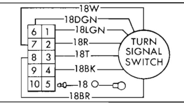

Go back in the car and access the column connector out of the signal switch. I cannot remember which is left and right, the fronts are light green and light tan, I believe.
if you have 1 indicator out and the other in its pair works flash unit and switch work
check the connector block for the column switch where the pulsing flasher signal is directed to left or right circuits.

Well I told you to access the TS connector where it comes out of the column. That is not difficult. You can check the voltages there. Don't you have a wiring diagram/ service manual? You can download those, free, from MyMopar.com

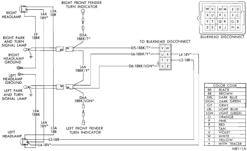

Follow the path. Look up which front output is which coming out of the ts switch connector. See if you have it there. Look up the bulkhead connector. Same wire colors there, should have same power there. If you have that and it does not work, it is either a grounding problem, a bad bulb or a socket problem
69 Dodge manual, 8-99, figure 7, "Front end lighting"
Notice Tan, right side, goes to "V" in the bulkhead connector. Left side, Light GreeN, goes to "S" at the bulkhead. These then go direct to the TS swictch connector coming out of the column
then go to fig 11, page 8-103, instrument panel Notice the same Tan and Light GreeN these feed out to the instrument panel indicators and out through the bulkhead as noted above

Oh yeah, I definitely don't understand it. I'm no mechanic. I did a four-speed swap on my last dart by myself and have been around cars my whole life. I just haven't really cracked into it myself much. What I mean by The signals aren't working, is the light in the grill but yes, the one in the cluster doesn't work as well.
The bulb is good. I have swapped it with the working bulb and I also have other bulbs here. Tried them all. Nothing works.
Yes, both grill signals are working when the hazards are on. The dome light is also pulsing with the hazards/ flashers. Weird.
Yes, the needle is moving rapidly when the car is idling. It will also flicker but only with the passenger side signal. The tach is an Auto-Meter. We wired it in the way it was wired in when I bought the car. We didn't really trace where the wires were going. That might be part of the problem.
Also, I'm assuming I have the wire on the back of the hazard switch correctly? It will go on either way.
Thanks so much for the help!
I don't know why you got into the column. It is not clear to me what electrical checks you have made. I cannot make this much clearer. You need to go back and re-read my post. EG, for each turn signal, not the parking but the turn, there is ONE wire that comes out of the column switch DOWN UNDER THE DASH, goes through a specific bulkhead terminal, which I talked about earlier, then the harness from there goes up to the lamps. You need to see if you have power at the proper color wire, with it flashing on the "bad side" so left front will be Light GreeN LGN.
I'm just going to take it to an electrical guy I was referred to. I'm out. Too much for me. The brake pedal sensor wasn't adjust so I got that done. After I got done that, now I have no signals anywhere. Also only my passenger rear brake light works. I changed the bulb on the drivers side and it still won't work. Unreal. I told this electric guru about the dome light pulsing with the hazards on the phone and he said to take out the left bulbs, front & back.... then try it again and there shouldn't be pulsing. It still pulsed. He said I must have a short somewhere. The wires to the hazard flasher started to smoke. I'll take it to him on Friday. Thanks for the help.
Even if you take it to an electrical guy, you guys need a '69 Service manual so know what wires are what, and where they should connect.
You can download a digital version from www.mymopar.com and its free.
Yes the tach wiring may be part of the problem. See where it is getting power from. It may simply be showing the effect same as the dome light is.
Since the turn indicators in the cluster both work with the hazard switch on, that narrows down the scenarios.
Do pay attention to the ammeter. The needle shows 40 amps charge to 40 amps discharge. Anything over 20 amps either way is getting into problem territory.
Use your own common sense too. Since your noticing smoke, I agree soemthing is wired poorly or wrong.
Another resource for routing and connecting the wires is to buy a copy of the assembly drawings from Faxon. You can find threads here discussing those and decide if its worth it to you.
When I turn the park lights on, the right signal which is working, slows down in speed.
One reason is the system voltage has dropped. In other words this may be normal.
Say the engine is running at 650 rpm. The alternator providing power to run the engine, recharge the battery (amount seen on the ammeter), plus power the turn signals, and then run the parking lamps.
With all those things drawing power, voltage might drop from say 14.4 V to 13.9 V. That would result in less current though the flasher unit and therefore a slower flasher.
