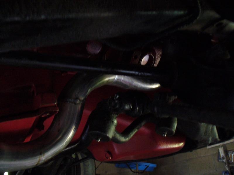

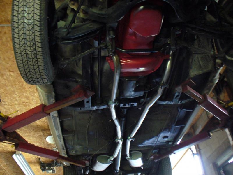

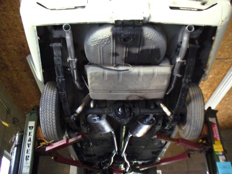

I put duals on my 1964 Dart Gt the whole kit was $285 manifolds to tail pipes from kepish exh and I did redo the trans crossmember
