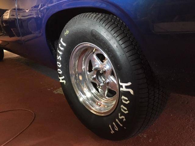

'73 Duster, cloned to a '71 (tail panel, front clip), 7 1/4 rear end: You can fit 295/50/15 on the rear, as pictured here. Not sure of the backspacing that the rims had though. Tires would only rub if they bottomed out going up into the curve of the fender well (if you get what I am meaning to say...lol). Had air shocks on rear to stiffin' it in the rear to prevent it from bottoming out on bumps with a load (2 people) in back.......so, you can fit up to a 295 with minimum rub issues.
Only with the rear end jacked up in the air like yours is. And, if it rubs over bumps, or loaded, or going around a corner it means the wheels don't fit. Wheels that fit don't rub.
I run a 295/35/18 on the back of my Duster as well, but my car is lowered so the wheels actually have to fit inside the wheel wells. It takes a 1/2" spring offset and another 1/2" trimmed off the quarter lips to do it, and even then barely. Sure, if you run air shocks and destroy your shock mounts you can run darn near anything. Doesn't matter if they hang a 1/2" out of the wheel wells if the back of the car is 3' in the air.
