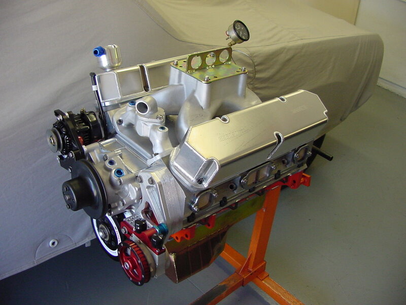

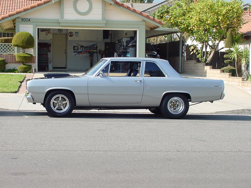

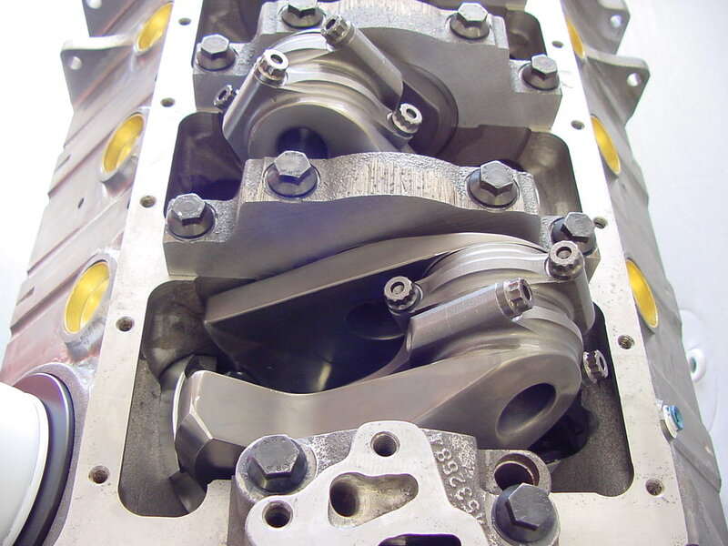

That was in his next car, the Silvaliant. He went overboard with the lightest parts he could, and the 501 didn't last long.
Other than his late model Challenger stuff, I was most impressed with his 71 demon. Silvaliant was drop dead gorgeous, and even fairly fast with the crate 360 that it got after the 501 got hurt.
wonder if anyone got the 501'' off of him when he gave up on it?
I remember when that 501” deal was going on…….it was quite a saga.
Too bad it never really played out as hoped.
It was a good read though.
Unfortunately I don't know what became of it, or how hurt. I know where silvaliant went, who has it, and what it runs now. (Not-really tuned properly, Mopar crate 360 in it)
Still damn pretty tho.
I could happily eat off the underside of his stuff. Unbelievably clean for a street driven race car. And the engineering? Ron is a retired Homer Simpson, only very, very smart.
jesus man... that motor... he had soo much thought and planning into it.. and the money.. Bryant crank even...
