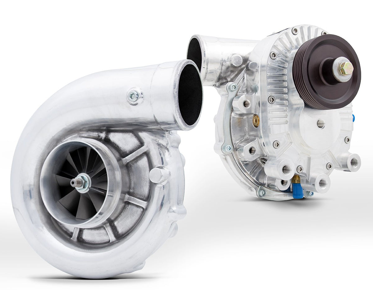

Centrifugal supercharged? That’s what that graph looks like to me. Rising boost curve.
Yes, it's a Paxton Novi 1500SL. I'm spraying methanol into the volute with a Prometh system, but no room for and intercooler. It's getting pretty crowded in the engine bay now. The dyno readout was with 11psi on pump gas with no methanol injection.
Yes, it's a Paxton Novi 1500. I'm spraying methanol into the volute with a Prometh system. The dyno readout was with 11psi on pump gas with no methanol injection.
Does that fit under the hood? I had a procharger on my FFR, but with a 8 rib, not that manly 12 :)
It does, but it's getting pretty crowded under there.
