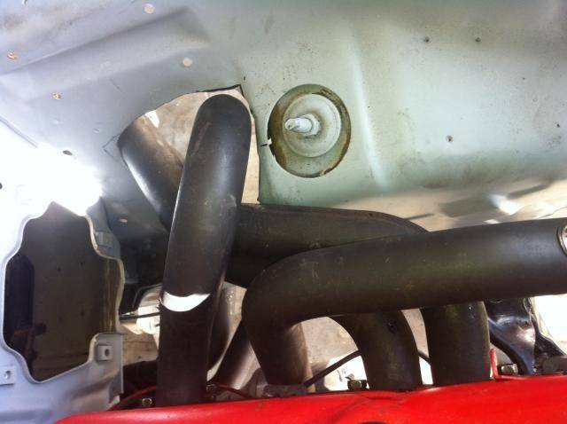

all i have are 2 pics and my friend sold the car never finished,,,the way to install the headers with these smaller holes is to jack up the car on jack stands remove the wheels and as you slide the header down in to the opening u spin the header to clear any thing in its path, here are the 2 pics

Those cuts are definitely more surgical than the butchery that is recommended in the Hooker instructions.
I would like to thank this person for this great ideal and not cutting a big hole in the fender well, it worked out awesome just as it says i took the wheels off and just snaked the headers in there and they fit great.
glad it worked out for u
Looks great. I'm getting closer to cutting into mine as well. On your driver's side, looks like you have room to spare. Or is that cut just about the right size to snake the header through?
That cut is just about the right size, with motor in i may have to cut a little more to get them position right.

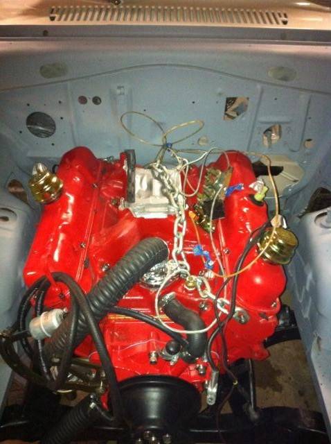

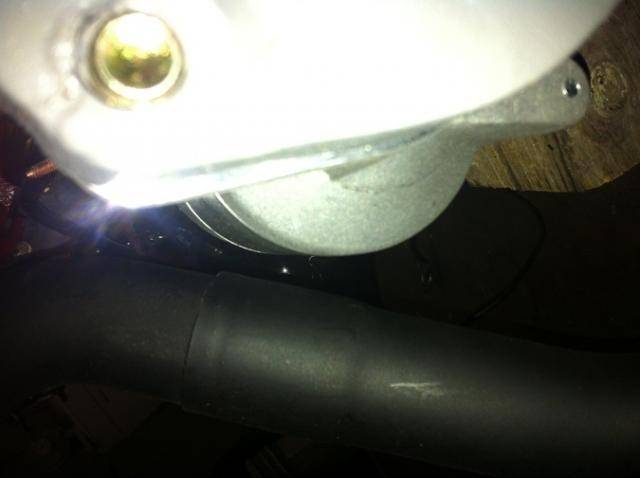

Thought I would share these pics while the headers are still kind of pristine and the engine is out of the car.
*With the mini starter you can see the clearance between the headers. About 1/2".
*And there appears to be a "gotcha" with the 727 trans. The lip of the 727 pan is up against the #2 tube. At least with this pan which is a mopar steel deep pan. I'm going to try and cut away some of that lip to provide clearance.

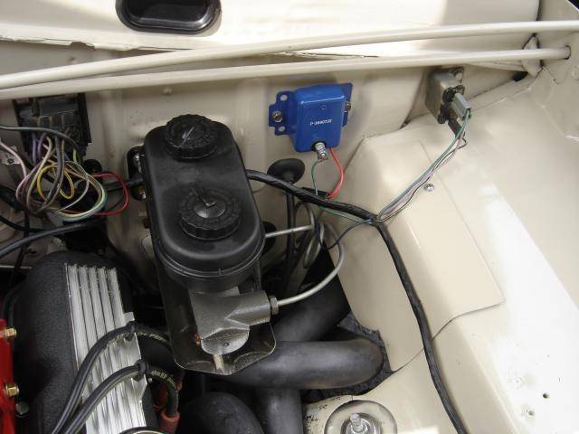

Here are some pics of mine....I cut the hole smaller, but made a cover, most people never even notice a hole is there :glasses7:
I love your engine bay. I've saved pics of it before to have as a reference for mine. Yours is very clean. I'm going to follow your lead and use the small alum brake master cylinder as well. You are using the Schumacher mounts it appears. They seem a little taller than the factory 273 mounts. Did you get better K frame clearance with them and the oil pan? I love your air cleaner also. Would love to know more about it. Looks factory. Thanks again for sharing the pics.
Thanks! I was going for a nice clean look so I appreciate your comments:glasses7: Sorry for the late reply, just seen this now.....First, yes, those are the Schumacher mounts, I swapped out a slant six so I never noticed how much higher it sits over the 273 mounts. I have a deep Moroso oil pan that hangs down, fits good but can't drop the engine in the car with the trans attached....oil pan hit the k-frame so they had to be put in separate.
The smaller master cylinder worked great, be sure to get the adapter block to use, it allows a 2-hole new style to bolt up, I even was able to still use the stock master push rod....the heat sheld is another nice item, they get pretty close under that thing.
The air cleaner in those first pictures is a Max Wedge cover on a Mopar Performance base, I painted it wrinkle black, looks cool but took it off after I installed the hood cause it still wouldn't clear so out came the side cutter and a bigger taller filter went on instead.
If you have any more questions about my car, feel free to ask or shoot me a PM :glasses7:

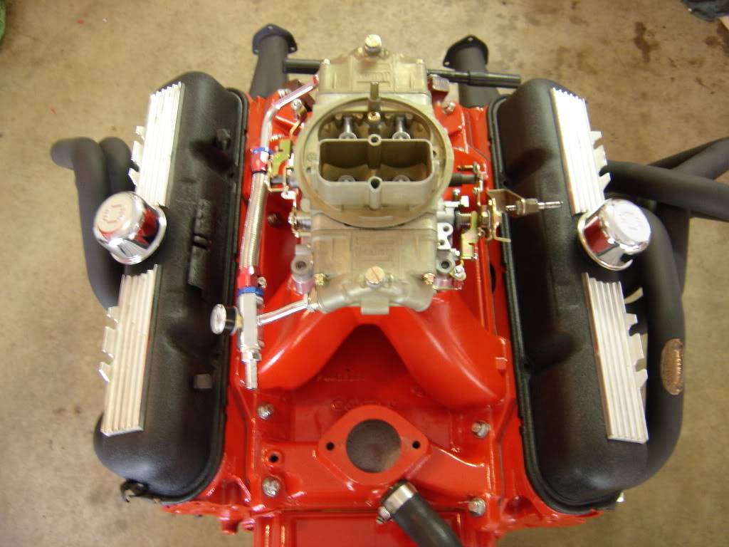

Stabbed the engine/tranny yesterday to finish up the fenderwell cuts.
I started the holes with a 4" hole saw but still have a bit more cutting to do to get the headers to snake thru and fit.
Anybody else finish up these smaller holes and get the headers to fit?
I'm going to try and make them as small as possible but I can tell already it's going to be a frustrating process of putting on and taking iff the headers and slowly cutting away sheet metal. -Mark

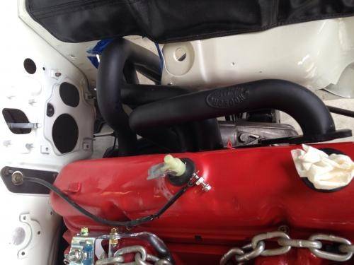

The small holes work. Of course my car is an ideal situation for doing this; no fenders, no wheels or suspension or brake MC.

Got everything mostly buttoned up. Small cutouts work, but it's tight.
I assembled both sides of the headers and threaded them thru the fenderwell cutouts BEFORE installing the motor. I put the motor in from the bottom but I think it could be done through the top. I don't think these headers can come out fully without pulling the motor though. Definitely looks better than those giant cuts Hooker recommends.
