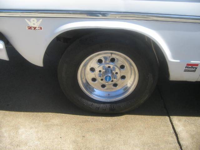

I am running 7.10X15 front tires, but I did stretch the front part of the wheelwell.

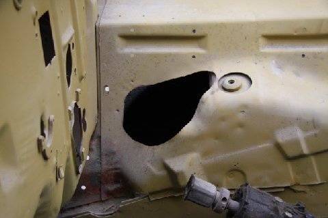

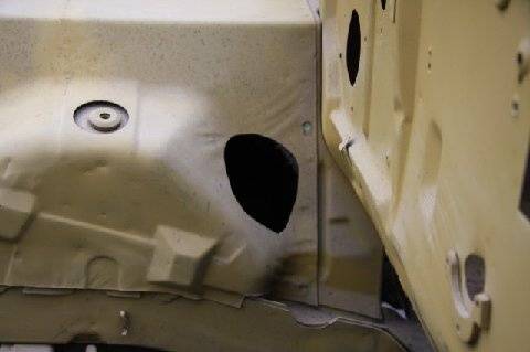

Anybody have any pics and/or measurements of the "smaller" version of the fenderwell cuts that are supposed to be made for the Hooker 5208s?
I found the attached picture after consulting Dr. Google. Would love to see the other fender on this car or a similar one and have some basic measurements to go by.

i posted that pic, some where on this site,, let me look see where i have the other fendr pic pm me with ur e mail ill e mail it to you,, and u can post it,,,the pic is in a file that wont load

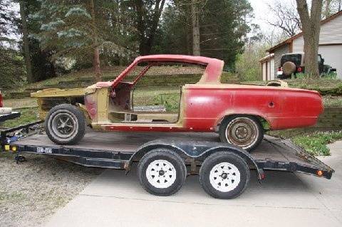

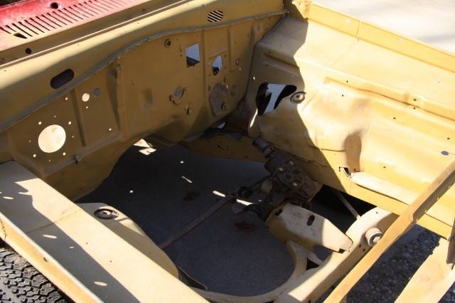

all i have are 2 pics and my friend sold the car never finished,,,the way to install the headers with these smaller holes is to jack up the car on jack stands remove the wheels and as you slide the header down in to the opening u spin the header to clear any thing in its path, here are the 2 pics

the guy that now ownes this car is in canada on this forum some thing like i got a 67 gt is his screen name
