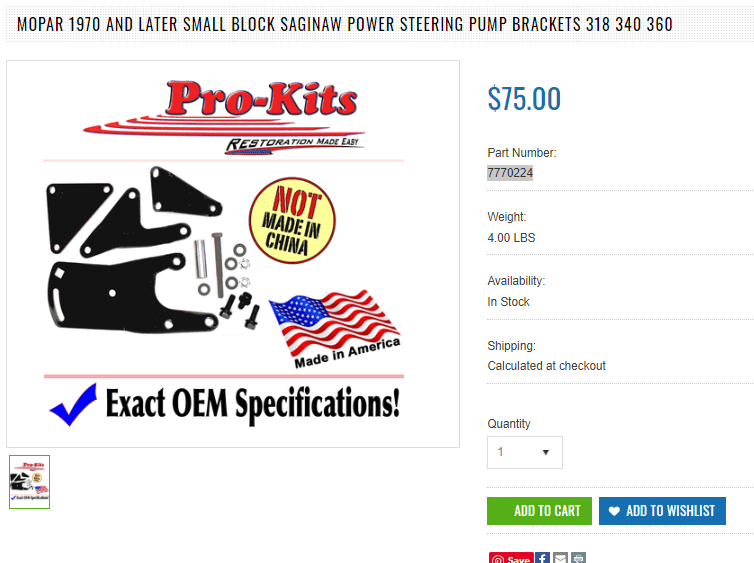

Good Afternoon all,
Hoping you can help me, help help a customer.
Customer has all stock bracketry off a 1968 318. from his running/driving barracuda.
it had the early driver side dump water pump.
i have confirmed it has a saginaw PS pump, not a federal.
He has bought my 408, which for this discussion, is a LA360, with LA timing cover, and LA alum water pump with passenger side exit WP.
His "early" ps bracket will not work. (my oversight)
I found this bracket for a saginaw pump, and for the passenger side alum WP he has on the engine.
my concern, is if i get him this bracket, his original pulleys will not line up, and we'll just chase our tails forever.
Anyone done this, have any wisdom for me? As simple as buying this bracket, or no...
thanks all.

That is for the later 70+ setup and youll need the later pulleys if you go that route. I have the correct pump and brackets if youre interested.

You just need the pulleys then?
Jake
what all pulleys would need changed? Just WP and Crank? or the PS pump and Alt spacing wonky too? (if i get him that PS bracket from my post)
Yeah, if he has the 64-69 water pump and crank pulley as well as matching power steering pump you'll need to switch all of that. Im not sure you can use those brackets on the early pump, youll need the correct pump. Do you have any pictures of what is on there now?

it 100% has a saginaw pump PS pump. i do have pictures of that.
U will need the 70 up pulleys. The alt brackets just may need to be spaced out, u may need a longer thru bolt also. The 70 up brackets for the p/s can be found easily also. Kim
Thanks all. I'm just going to get him hooked up with an aftermarket Front drive. Chasing pieces parts is going to be more trouble than its worth.
