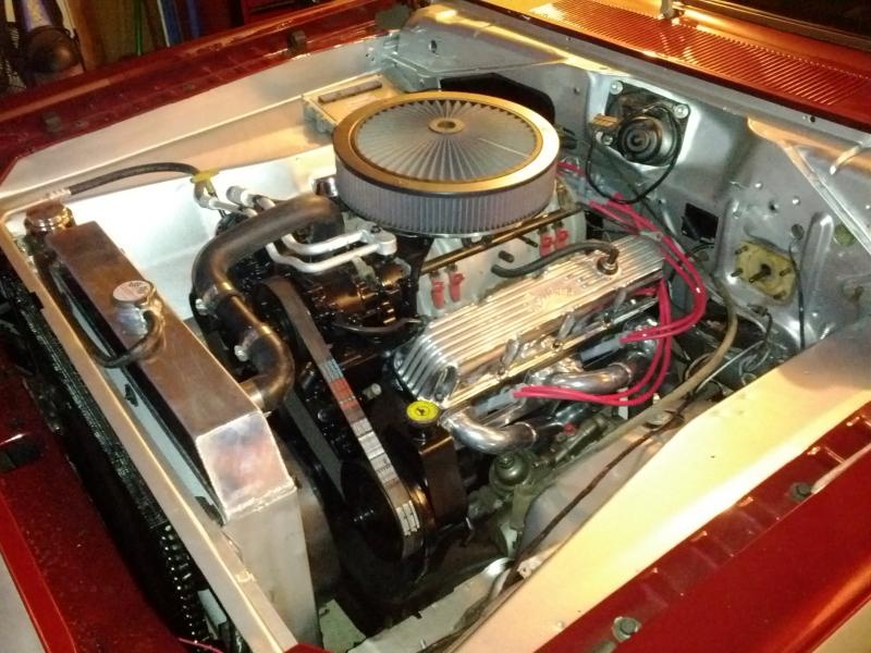

For the op, what type of brackets do you have? All my original brackets came off an '88 Gran Fury w/318. I fabbed up an adaptor piece that allowed me to set a small Sanden compressor in that space. It looks good, I hope to get the plumbing done in the next couple of weeks.
C
I ended up buying a Sanden SD510 compressor. I just need to clean the engine bay up a bit when I install and it should be all set.
