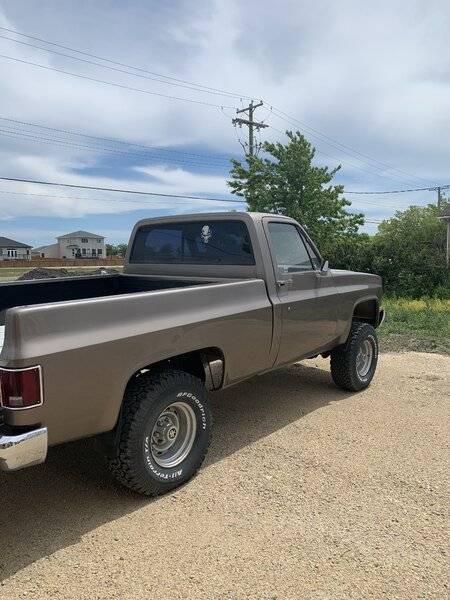

I have them in the front and back of my square body…. with a full time transfer case… no noise out of either differential…. But on ice or snow covered roads the truck can do some interesting detours if you don’t pay attention
