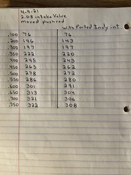

Well is time to stop fooling around and get this 408 together for race season. I had a number in my head (330 cfm) that I was aiming for on this project. I actually hit 333cfm at .750 but I wasn’t happy with the mid lift numbers and with me only running a .650 lift I changed up the short side shape to concentrate on the lower lift numbers. First off I will never do this again in my life moving the pushrod over that far with all the extra work involved. Head flow numbers left column and with ported Indy intake numbers on the right. Hopefully this will get me some 9.50’s soon

Minimal losses with the manifold attached.
It looks like you were able to get rid of some of the radius under the 45.

Ya I started off by just doing a deeper 60,45,30, and a 15 but then I ended up opening up the throat .030 and I’m still probably only at 87% valve ratio. With the .650 cam I’m running I’m pretty satisfied or I would open it up closer to 90%. It’s time to move on. Lol

For a head that’s many many years old they don’t work bad but they are what the are. You can only make the short turn so big the way they are made. Controlling 400 FPS across the whole short side is hard to do and results are limited. I hit 318 cfm without moving the pushrod but the intake helped me hit that number and actually raised up because of the intake. Those head ran 10.11 in my sons duster with a 727 at 3250 pounds on a worn out engine. And 9.74 in my duster at 2860 pounds with a powerglide. As you can see the work involved isn’t worth it.

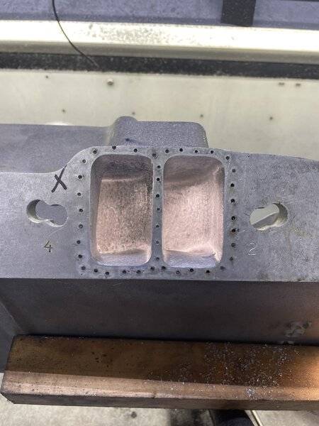

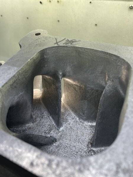

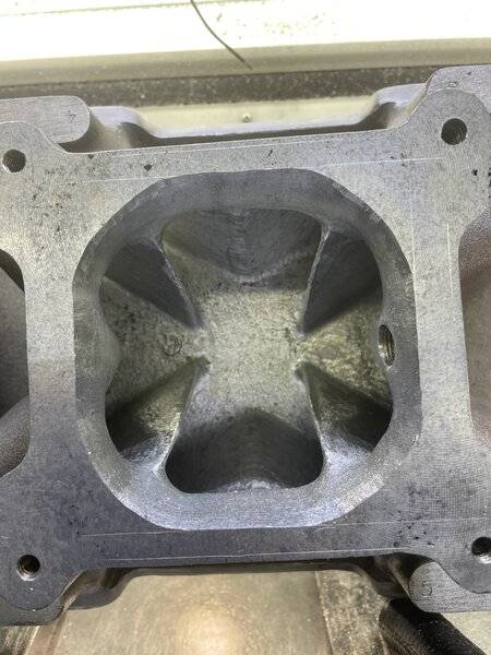

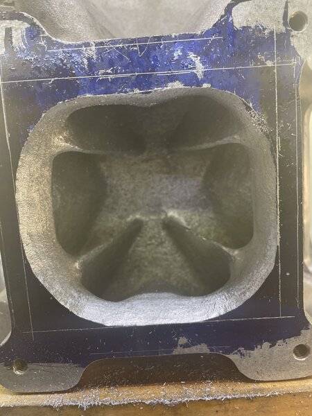

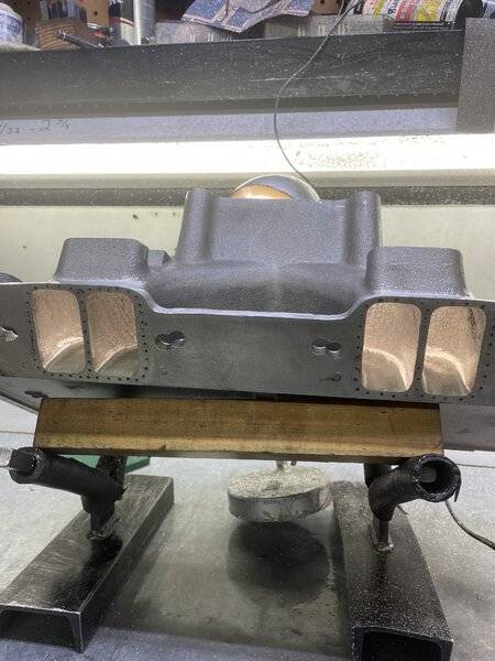

Sometimes the hardest person to please is yourself. When I start out flow testing an intake I ported or in the process of porting I will usually test an inboard port of the intake. (3-4-5-6) because if I can get good numbers out of them the outboard ports are usually a cakewalk. The numbers I posted above were from number 4 runner. Although ok I hate the way Indy intakes, super Victor and a couple others leave a ton of material that shield the inboard runners. For the test above I cut down the divider about 1/4 inch to open it up some. It worked but while cutting down the other 3 dividers I get the bright idea to open the plenum up some. I wish I would have taken better pictures but between the ones above and this one you will get an idea how much material there is.

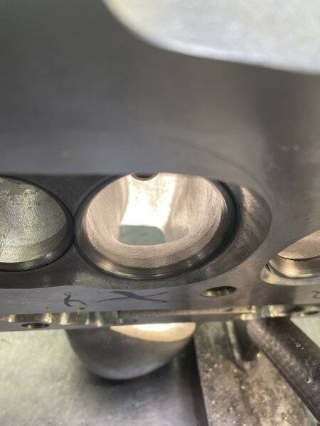

Being way past burned out on this project and several days of work left on the heads I think I’m now done. I could spend another day making it prettier but pretty is time I don’t have. This is another time I wished I had a Mill instead of doing it all by hand, but I don’t. You wouldn’t believe the amount of aluminum chips on my bench and floor from this project.
Time to finish up the heads and get this engine in the damn Duster

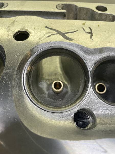

Damn, that's a lot of grinding! You may have stated already, but what're the punch marks around the intake ports for?
