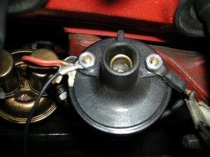

On with the diagnosis! I replaced my ignition switch and opened every wire bundle under the hood to verify that everything was connected right. At this point I found that a shop had put the coil in backwards and added an extra condenser to make it work. The PO had installed an aftermarket ammeter by running a wire thru a post crimper, bending it over once, and pulling vacuum tubing over the whole mess. A few wire caps and a re-wired firewall harness later I had a constant 3 volt gain at my coil.
My coil wired correctly, the red wire is the extra condenser:
So now electrical is better but she still wont start.

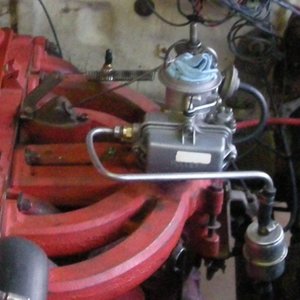

The throttle response on my old Holly 1920 carburetor was shot so I thought I'd start with a carb rebuild. I dunked all metal parts in a cleaning basket, wiped em down, and blew all passages out with compressed air.
Dirty carb:
Clean parts:
All done:
She still wouldn't start! Ugh! Okay what now?
