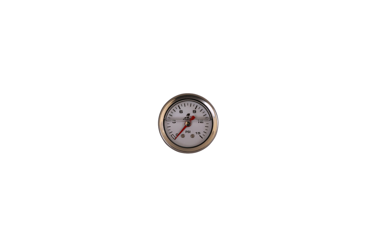

My fuel pressure gauge is 1.5 diameter, liquid filled, with a 1/8 female NPT port.
Mounted on the throttle body, liquid filled so the needle is readable, not effected by underhood heat as it's far above the hood.
In 8+ years I've gone through multiple FiTech, Summit, and other brand gauges, too many to count.
They're always the same, no matter the brand, of course the design changes a bit over time, the price changes, sometimes one brand is more/less $, but the quality stays the same.
Surely they're all made by the same conglomerate.
They all last a decent amount of time, but all eventually fail.
Can anyone recommend a proven 1.5 diameter white liquid filled gauge?

I use exclusively aeromotives gauges. Never had a failure. But mine aren’t located where yours are.

I have great luck with these, but like any liquid filled gauge, they are always affected by temps once warm. We sell all kinds of regulators and gauges. They are very reliable, and I have used all of them numerous times. I actually run 2 on the dart. One pre regulator, and one post regulator.
