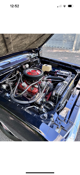

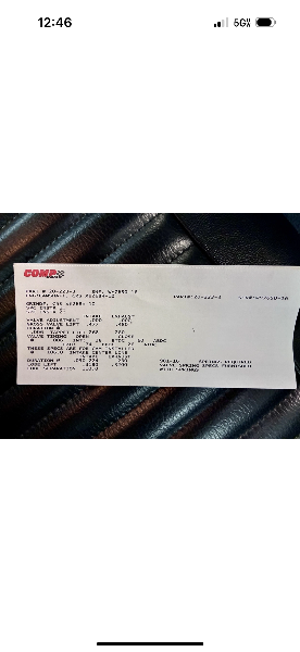

Hi everyone. New to me is a 1970 Dodge Dart Swinger that has had its transmission (4-speed 833 now) and carburetor (Edelbrock now) and cam (card shown) replaced. I want a regular driver i.e. road trips and around town whenever there’s no snow or salt. I’m told by a couple of local mechanics that the Edelbrock is terrible and have been recommended (by a purest) not to EFI but instead to re-install a Carter. The car was surging terribly last week it almost died several times; a mechanic said the carb looked wet in the secondaries. My hope is to keep this car for a long time and if so it won’t be kept original by any means anyway. So does anyone have an opinion whether the Sniper or other EFI is a good move for reliability and easy starts. I’m told also that kits don’t have sufficient sensors (i.e. only a single O2 sensor?) to perfectly meter. I’m Imagining a rear gear change and electronic ignition upgrade down the road too. If I’ve missed a thread addressing this already I’m sorry and could jump to it if that’s better. Many thanks for any opinion or ideas!
and they are a bunch of idiots.. don't take any advice from those clowns.. an edelbrock carb is perfect for what you say you want to do.
rebuild if need be and tune that eddy carb and it will cruise great and be reliable.. ( i pefer the holley style only because i have parts and know how to work on them more then an eddy)
i've gone back and fourth on the efi thing the last couple of years with our dart. i've decided to follow the K.I.S.S method. i have a friend with a sniper and his car runs good with it. problem is on a road trip if something goes wrong where are you getting parts for it? that eddy carb is an easy replacement. electric fuel pump. if its in tank which is the best way is a pain in the *** to change on the side of the road also. stock style mechanical pump is a quick and easy fix on the side of the road....
i did a 5500 mile road trip last year in our dart and a 1200 mile trip this year.. and after this years trip where i lost a fuel pump i'm keeping the carb and mechanical pump. easy to get and easy to install.. no need to over complicate the car in my opinion.. hell, i'm even pulling the MSD RTR dist. and installing a stock style one this winter for the same reason.. keep it simple and easy to get parts for..
not pulling a tank here to do a fuel pump.. :)
Welcome to the site. You know that 1 pic isn't enough, right? By the time I enlarge your cam card its pixelated. Could you repost?
Carborated engines are much simpler than an EFI engine. Read a few articles on both and make your own decision. 65
Edelbrock carburetors are fantastic. Sounds like you took your car to dumbass central. Find a new shop or learn to work on it yourself.
Eddies are junk? Get a Carter? Uh... they're the same carb, basically.
For a reliable, "running around" car, stick with a carb. I've been down the TBI/EFI road, was really nice- when it worked. Went back to carb, for the exact reasons already mentioned- parts availability.
Carbs (and I'm a Carter/Eddy man myself, nothing against Holleys, Carter/Eddy just suits my style better) have always worked well in the proper application, and will continue to do so today. Read up or find someone who is comfortable with your brand carb and get it tuned right (local car clubs are great for personal knowledge or recommendations) and never look back.
The guy you took it to doesn't sound like a mechanic; he sounds like a "parts replacer". The secondaries "looked wet"? Really? Ever think of adjusting a float height or replacing a gasket, or just do some basic diagnostics? No, let's just throw a different carb at it, or better yet, slap a whole EFI system on it (we can REALLY make some money there!).
Find a GOOD local guy, they're out there.
I couldn't really read your cam card. The few numbers I could make me think it's an XE268. Maybe a few more details? engine size,etc? Is the carb new? From 1984 to 2019, I drove exclusively 60s-70s cars with carbs as daily drivers , all kinds of weather . But I'm a weirdo.
If you don't want to get towed home stick with the carb. The only good EFI is the one from the AUTO Mfr. that is installed on your car. 05 Ram 20 years old never failed me. 2 strikes against aftermarket EFI and 2 different types and Mfr's..

In the end, this car is my daily (other than wet days) and I want to take long distance trips so I'm staying with the carb and diving into learning the Holley/QFT. I am installing a vacuum gauge and air/fuel gauge. After much research I have bought a jet up and down and a power valve one size down to try out. When you get it dialed it will be more reliable and you learn something.
I wouldn't want to be too many towns away from my truck and trailer with an EFI deal now and I was really considering it. So consider that ALL repair/replace parts would have to come in the mail with EFI. On the other hand a fuel pump, pickup, filter, and even an Autozone AVS Eddy can be had right now in most towns! For my race car, EFI. For my daily and road trip car, carburetor.

I'd only go EFI if you have other goals here in play that you haven't mentioned. TBI type setups are only an incremental improvement over a carburetor, at a cost that's going to be a lot more than having a good mechanic fix the one you have or even buying and tuning a new carb. They have their place if you want a few cold start improvements and a programmable timing curve. Or if you just have the urge to check the "yep, I have EFI" box.
But if you are planning a turbo or nitrous build, want advanced drag racing features like traction control, or similar, my advice would be to go big or go home. These goals call for a multiport setup, and maybe other things like a crank trigger.
But if you just want the car running well and running for a long time, and there are no other goals - fix the carburetor.
