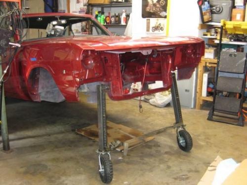

Shouldn't be an issue. It's not necessary to stand the car on it's back bumper.
In fact, if you put the back tires on a set of ramps it's better still. Note how high
Dartn440's car is from the above post. He could have done it with a 6' ceiling!
attachment.php
Photo Courtesy of Dartn440
Those wheeled channels could be adjusted up with pins. Didn't take much more to roll motor, trans, and front suspension right under. Standard 8 ft ceiling.
