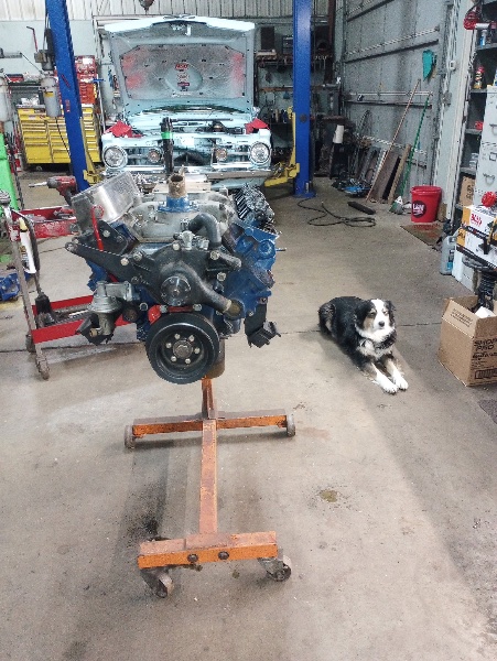

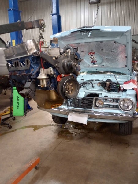

The engine was pulled yesterday. We’ve found:
2 bbl pistons (same as fender tag; currently running a Qjet with an Offy 360 intake)
Already .060 over, bores need to be honed. Are .080 pistons available?
My preference would be to do a build on this motor. Already .060 is an issue. From reading numerous posts there are issues building a 273 including. Head gaskets would be a makeshift solution.
I’m willing to have the work done but I don’t want to have $7500 in 273 that won’t run right when a 320 horse 360 is available for $3500.

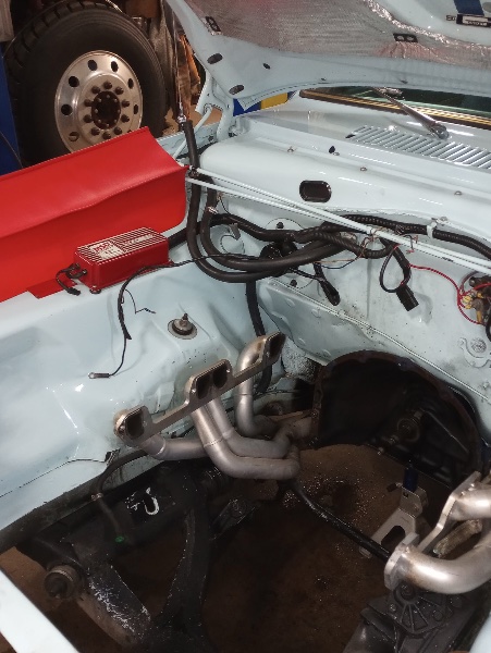

It all depends on what you want in the end, and what your budget is. Factory stock, find an A273 block with a date code correct for your car's build date. Inexpensive, a 318 build using most of your 273 parts. Street thumper, get a 340 or 360 block and all the related conversion parts. Race car.....the sky's the limit. Looks like you already have some performance parts with the MSD box and headers.
Even then, some 360 parts for that car aren't the easiest to find either.....such as the motor mount brackets, oil pan, flywheel (if manual), torque converter or aftermarket 360 flex plate (if auto) along with the reducing bushing.....
