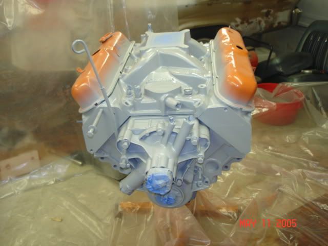

Does anyone know of a good primer for cast iron? It would seem like with any engine paint, it would be good to have some kind of primer (self-etching?) to seal up the metal.

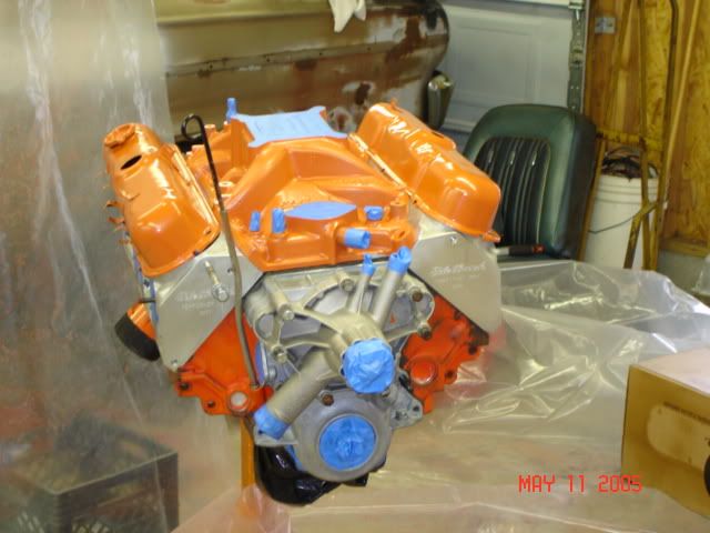

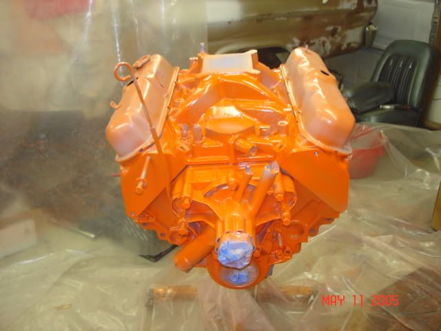

the purists say no primer. i use epoxy primer on my motors..
the valve covers and intake are the older mopar spray paint. way too pale compared to the original street hemi orange..
i used the utech 3.1 high solids single stage paint. code 5067DH. while the color will fool most it was way too much red in it if you want it as close to original as possible looking IMHO...
