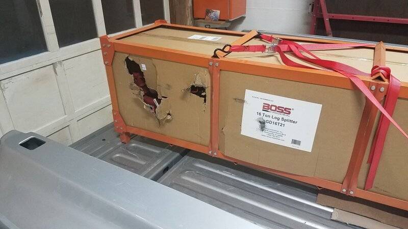

About a year ago I bought a small log splitter that came in a steel shipping crate. I thought it would be a good candidate for the frame of an engine test stand, so a couple months ago I made it happen.
Here's the crate when I brought the splitter home:

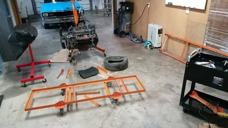

First step was to take the corner pieces and reattach them as the caster mounts:

Next I scavenged some more angle pieces off of the other crate frame to use as the lower mounting points.

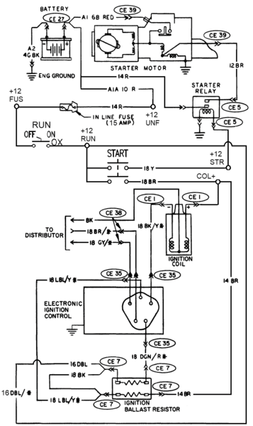

This is what things looked like installed. The ignition box and ballast resistor were leftover after I converted my blue car over to HEI, the coil came with the LA, and the other electrical parts I had in my collection of stuff from doing Industrial Controls engineering work for 30 years.

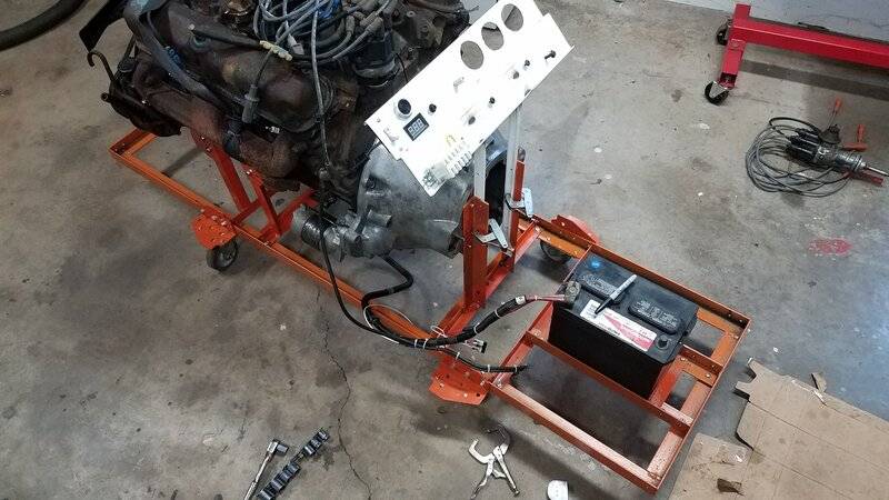

This is the finished product:
Total spend was $75 for the bell/flywheel, and another $2.80 for some fasteners I had to buy. Even if you had to buy the casters and the electrical parts it still wouldn't be too much. Not having to buy any steel really helps though.
