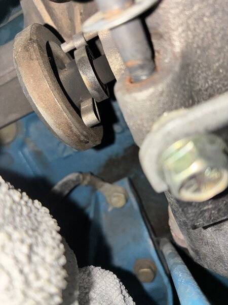

I have a 12R5153B Holley 1920 HOWEVER I did have to block off the upper diaphragm (pic below) since it was ripped and causing a vacuum leak.
That's your choke pull-off. It needs to work correctly or you'll waste a ton of gasoline, foul your spark plugs, and the car will behave poorly until it's all the way warmed up. You need a new choke pull-off.

Also I didn’t explain myself properly but it’s not necessarily a “valve”
Your car does have an intake manifold equipped for an EGR valve, and it has been blocked off.
but rather a direct access from exhaust to intake with this “valve” opening and closing depending on the throttle level.
That's the manifold heat control valve. It's supposed to be there, and it needs to be working (and it sounds like it is, by your saying it moves when you rev the engine).
It has a little tube (which I plugged up) which leads directly from the exhaust into the intake manifold, which after I plugged it I started getting the exhaust smell.
I think you mean the flex duct that goes from the sheetmetal shroud surrounding the central part of the exhaust manifold, to the underside of the air cleaner snorkel. About 2" diameter. It's missing, now I look again at your video. Put it back after you fix the exhaust leak which (going by your newly smelling exhaust after removing the flex duct) is either at the intake-to-exhaust manifold junction, or at the exhaust-manifold-to-headpipe junction, or both.
