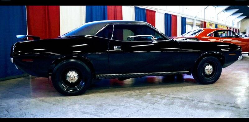

I went through a bunch of different leaf springs on the rear of my '70 E-Body in search of a spring that rode well and could handle the additional power I added over the years before finding the ESPO +2's. The ride quality is second to none, they didn't raise the car too much, and when combined with a set of properly adjusted slapper bars, they hook up very well. Those are 28 inch tall 325/50-15's on the back.

That’s a beauty, I reckon the 2+ work well with that size tyre.

That looks about how I’d like mine to sit. Are they 275/60 r15s on the back. I had come to the same conclusion that if I order 1”+ I can always drop them a lot easier than the other way round.

Initially, I was running BFG 295/50/15 on the rear. the ones pictured above are now 295/55/15 Drag radials. I also ended up shimming my front perches back 7/16" to help center the wheels in the opening better while I was installing the GV overdrive and having my driveshaft shortened to fit.

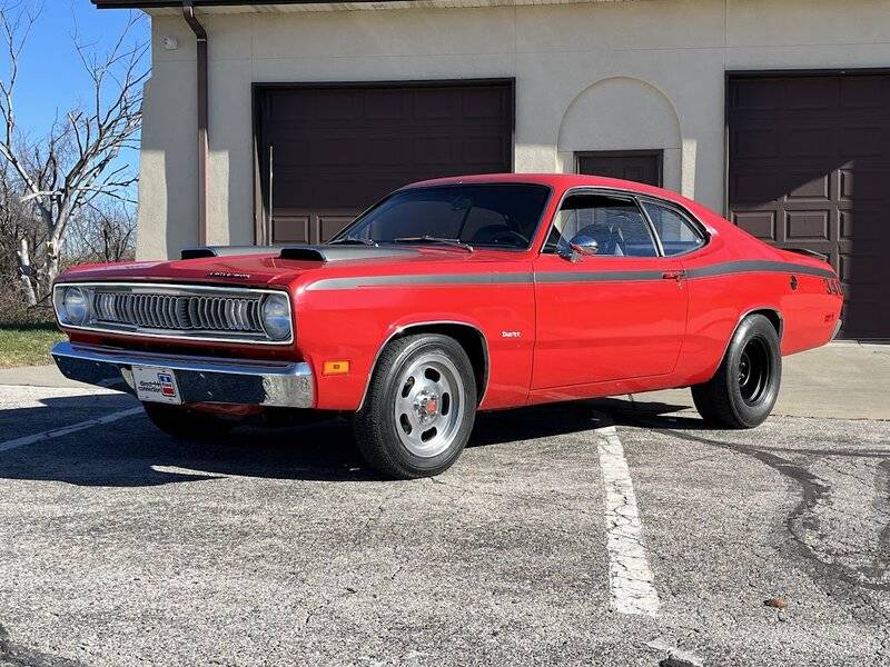

These are new (a year ago) ESPO +1 springs on my Duster. I think they have settled to their final height which is 28 1/2" from pavement to the bottom of the wheel well. I have bought a couple sets of springs from Laura and have no complaints at all. Hope this helps.

That measurement is impacted by the tire's aspect ratio as well, so take that in to consideration when evaluating.
Thank you HPP, good point. I guess measuring from lip to the centre of the axle would give a better perspective of spring sag (depending on loading in boot also)
