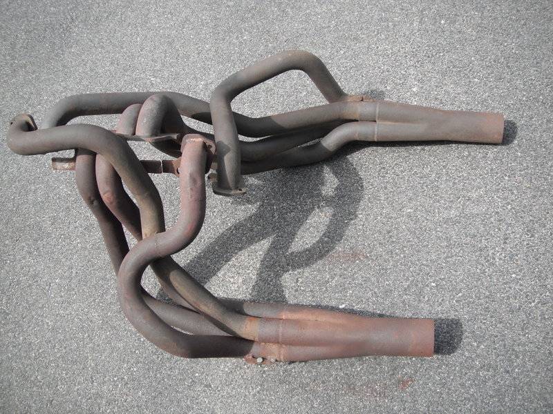

Hey Guys, Had a question, i installed hooker headers on my 74 plymouth duster and noticing a couple small issues! 1st: does anybody make a small enough starter to fit in the opening underneath? the stock starter does not fit and i have to lift the motor and disconnect the header to have enough room to remove it! I seen these mini starters online and was wondering if anybody has gone this route and did it work, or will you still have to unbolt things to get it in? 2nd: I have my steering bar shooting through the headers (only way it will fit, and i am noticing that the steering bar is touching the headers (keep in mind that i do have the car suspended up in the air with the front hanging, so i have not tried to lower the car back on the ground and see what clearance i have. just thought i would ask before putting the wheels back on to lower it and than lift it back up. Just curious what Duster guys out there have tried and ran into these two issues. Thanks in advance for any knowledge on this problem.

Should have asked for a header recommendation before buying the Hooker headers had them on a former duster they sit way too low,steering linkage goes through the driver side ect ect...on an A-body TTI's an Dougs are the most recommended much easier to install and remove and the mini-starter goes in and out no problem..
what Hookers are we talking about-part # - or size? I have had 5303 1.875" that fit no problem with a stock starter. and 1.750" that fit no problem.

Marco, that would be the typical 1-5/8, 1 size fits all header. The same design copied by every other manufacturer out there except TTI and dougs.

That is by far, the best fitting, best general header for A bodies around. The 5204 Hookers are second.
They don't make that header any more. I know there is a set for sale here. I should buy them.
