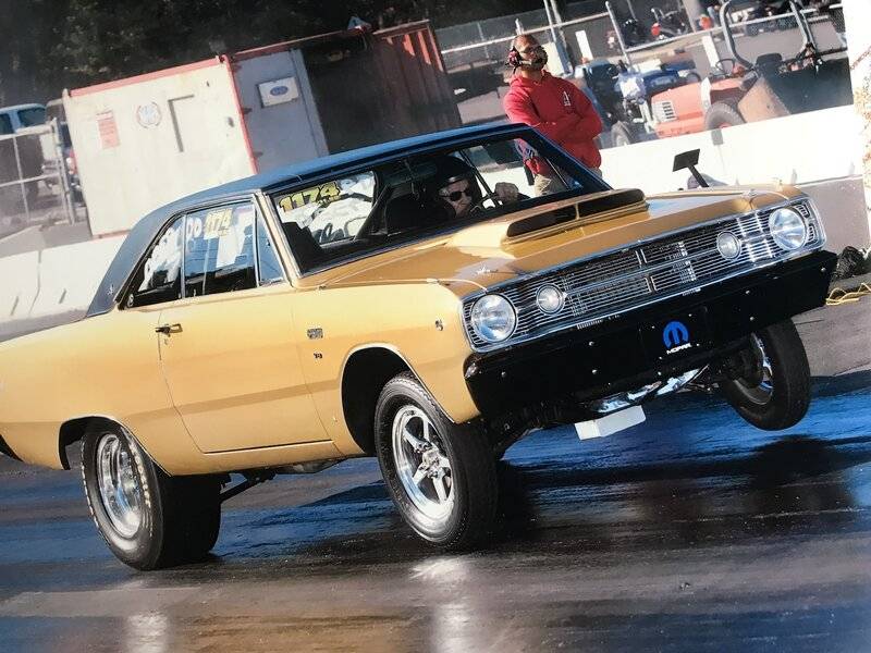

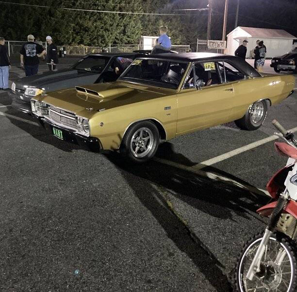

68 Dart race car 3,150 lbs with me in the car , 2,945 with out ... 367 inch small block / 904 / narrowed 8 3/4 , Cal -Tracs and Cal Trac mono leafs , fiberglass hood, trunk lid and bumpers , not gutted : bench seat , stock dash and door panels , carpeting , no back seat due to tubs but its carpeted , all glass no lexan , 4 wheel Wilwood disc brakes ( went from 11 inch drums in the rear to discs and saved 50 lbs ) Weld wheels on the front , Holeshot R3 15x10 on the rear with Hoosier 295/65 R15 drag radials , 8 point roll bar, frame connectors and a 10 gallon aluminum fuel cell , headers with exhaust and mufflers
