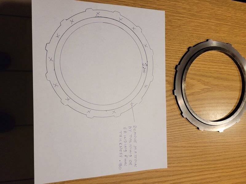

BTW SMCARNUT has a work around to get 4 standard clutches in a 3 clutch drum by modifying the pressure plate. Here's what he sent me.
I have machined a few pressure plates to increase clutch plates. My swinger has 5 front clutches and 4 rear.
I also installed 4 pinion planets front and rear. If I recall, a 340 trans will have 4 pinion front and 3 pinion rear and same for the clutch packs.
Dont sweat rebuilding a mopar trans. They are the easiest of all the transmissions of the big three.
The less springs in the high gear drum will apply the high gear clutch quicker when the car is shifted into 3rd gear. The more power the car has, combined with the higher line pressure manual valve bodies or shift kits, the more springs you will want in the high gear drum with more clutches. If you run thin steels and clutches, you should be able to get 4 clutches in the high gear drum without issue. If you don't have anywhere to machine the pressure plate like CFD244 posted above, you can purchase a new pressure plate that is thinner to run the extra clutch, or extra 2 clutches.

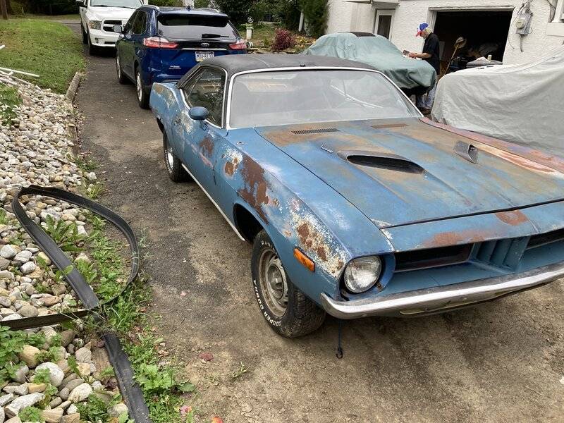

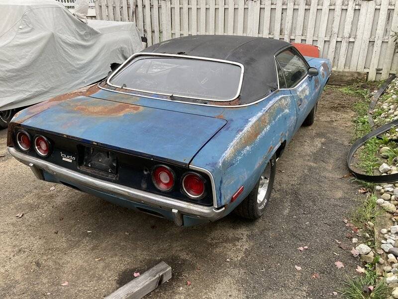

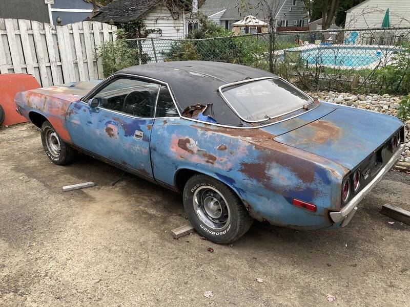

That car looks good. How does the firewall look? I had to patch mine in my 70 'Cuda. They rust is weird places.
Thanks my 69 will always be my first love but the e bodys are slick. Fire wall isn’t bad, lot of surface rust. Back half car is rough. Decklid, quarters, gutters, trunk floor all need replacing and usual floors need attention.
