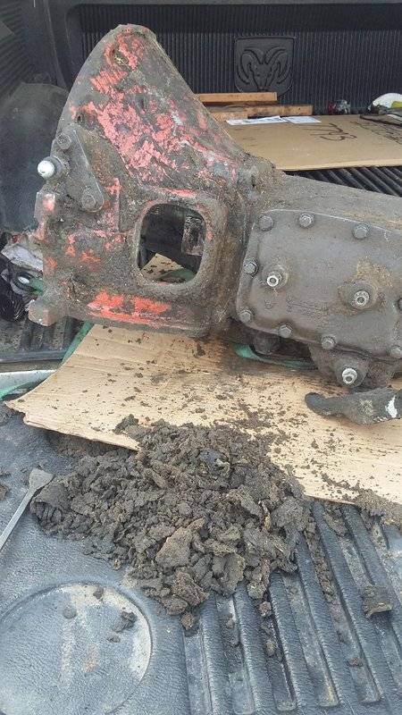

Definately all red... wow there was a lot of gunk on it ! Im quite sure its never been apart or painted.
Here is a picture of the original painted bell housing from my 69 Dart
I took quite a few 64, 65 & 66 Barracudas and Darts apart through the years. All of the bellhousings I remember were completely painted.
