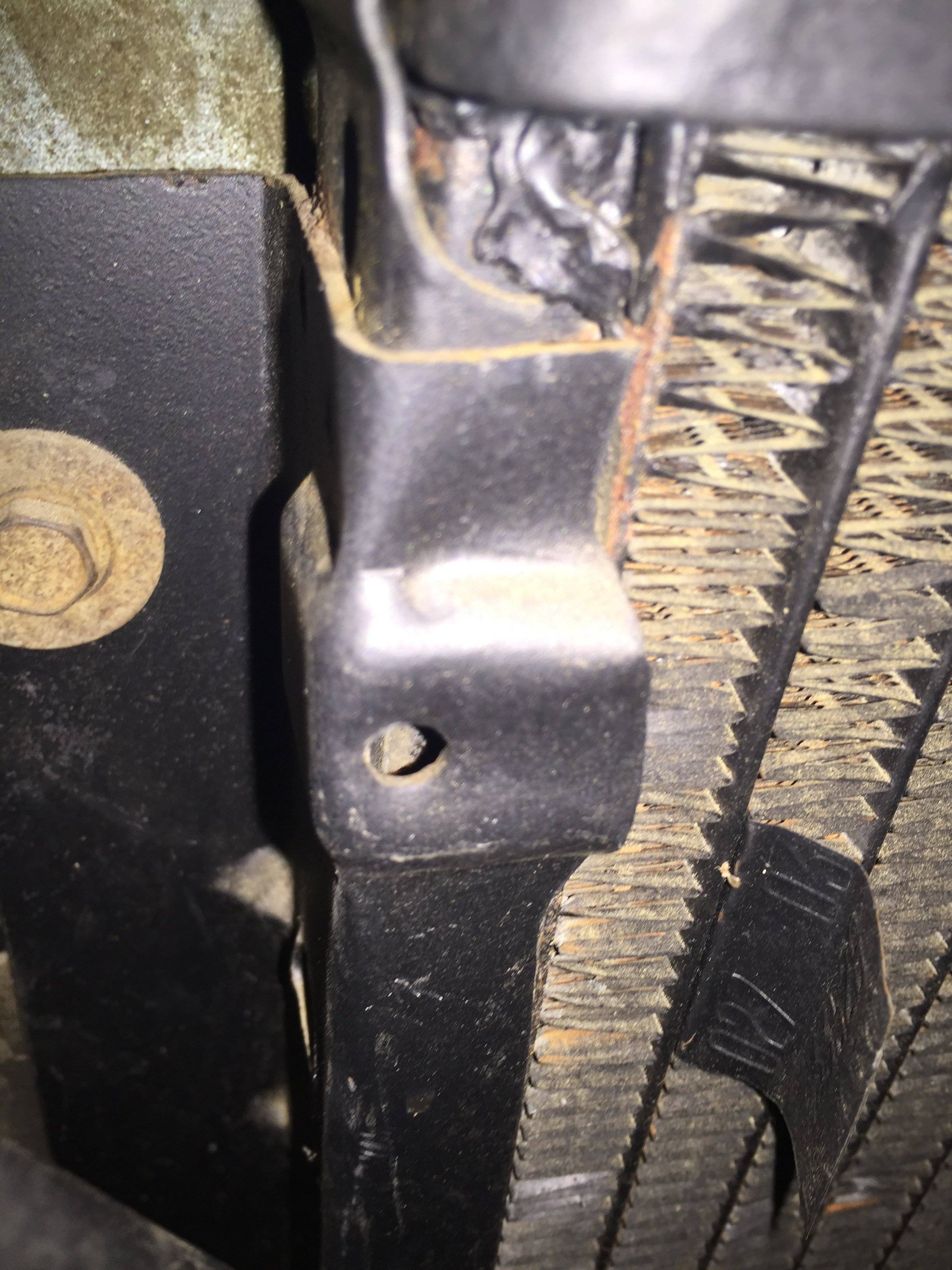

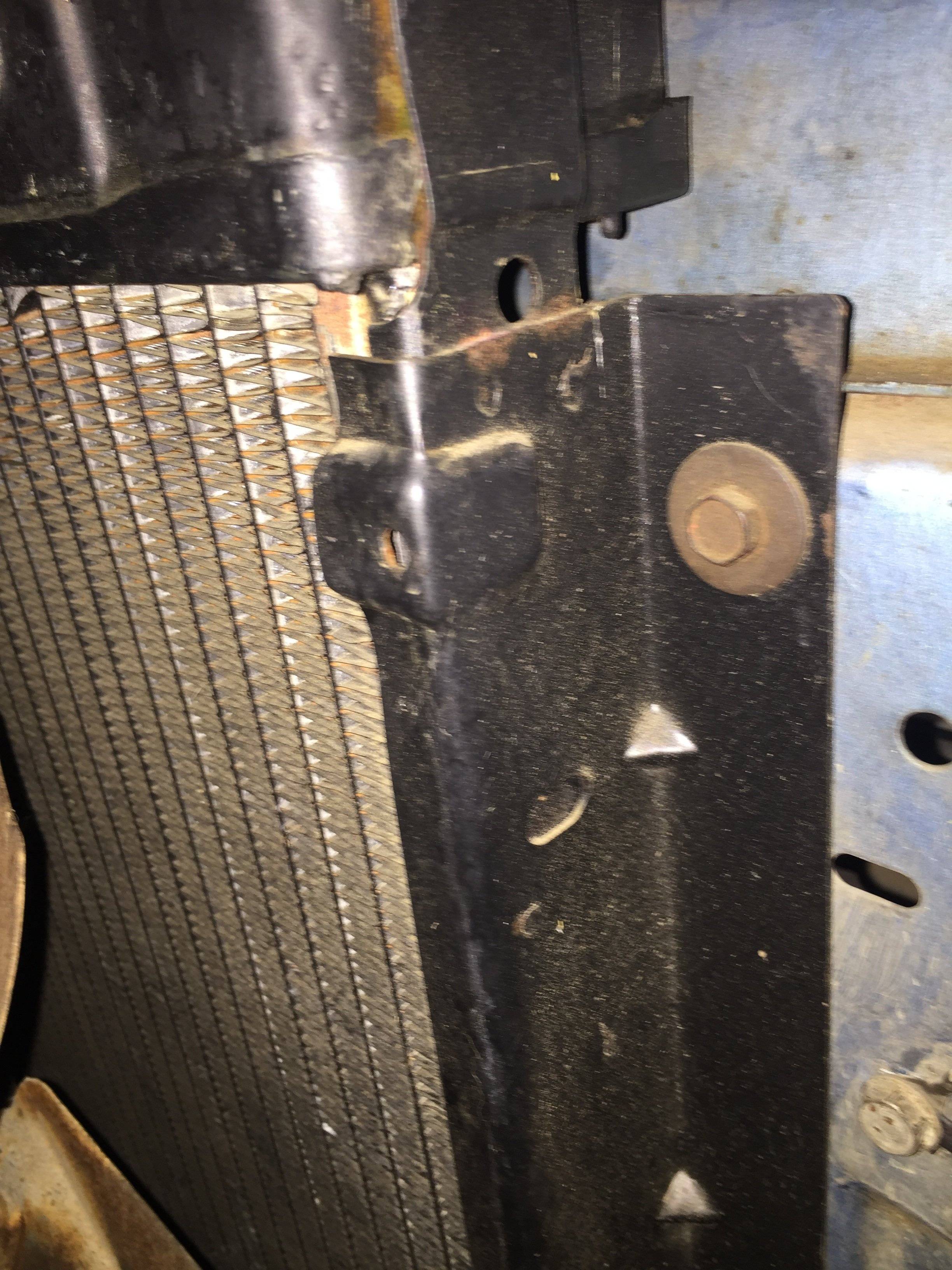

Having trouble finding the right fasteners to attach my shroud to my radiator. The clips are too small. I have the 22 in radiator but it is an autozone replacement, not factory. Could this make a difference? What hardware should I be looking for. I have attached pictures of the mounting locations for reference. Thanks.

Those clips look a lot like the ones in the mounting kit I bought. (I will confirm tomorrow when I get back out to the shop) The problem is either I am doing something wrong or when I slide the clip on to the tab of the radiator the holes aren't close to lining up. Its almost like the hole in my radiator is on the opposite side of the hole on the clip if that makes any sense. You can see in my pictures how far the hole is from the edge where the clip would slide on.

I think what is different is the mounting holes on that after market radiator. I have encountered that in the past. What I wound up using was larger sell taping screws, kind of like a license plate screw only for metal. Like the screws holding your voltage regulator on or the ground wires on the radiator core support. I screwed them right in the radiator hole without a speed clip. Hope this helps.

Well, it seems the aftermarket radiator is the culprit. Didn't get far enough to tell if the holes line up because the mounting locations themselves are about an inch off top to bottom. Thank you all for the replies.

Maybe you can get a couple steel strips from Home Depot. Mount them to the top and bottom shroud mounting holes. A nutsert kit from Harbor freight would work. Then mount the shroud exactly where you need it using short self tapping screws.

We just re-drilled new holes in the rad's side flange (with a thin plate inserted between the flange and core so as to not drill into the core) and put Tinnerman nuts on the flange, then cut some screws to catch the nuts and not be so long as to go into the core when tightened. Works fine. I'll get a pix when no longer raining...
