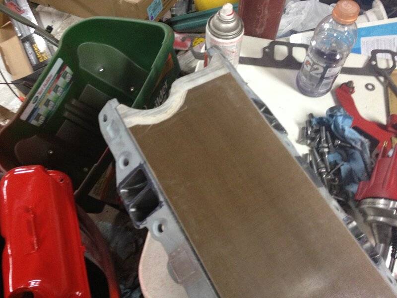

Has anyone used an oil shield under the intake before?
I made this phenolic plate. It rests on the end china walls. Takes the place of the cork gaskets. My cross over has been milled off.
Not sure, had changed heads/intake at the same time. It stops any leaks at the china wall area because it gets glued in place with rtv. Worth it for that alone.
