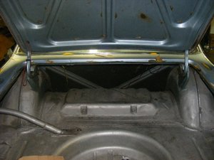

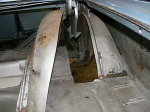

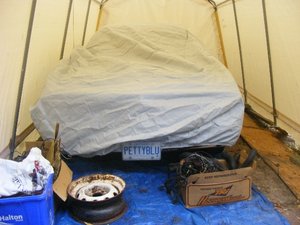

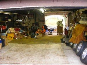

Well let the FINK(Fun)begin..HaHa!! car pics 66 Dart 029.jpgI got my garage partially cleaned up to make room for the mini-tubbing of the 66 Dartcar pics 66 Dart 023.jpgI have the 73 Dart Sport tucked away in the popup garage for the winter(cost me $249)as were the heated storage cost me $350 for the season.Peeky-blue!!LOL!POPUP GARAGE 011.jpgSo here,s some pics of the trunk before I start the minitub and spring relocation.I,ll keep ya,s posted with progress.car pics 66 Dart 028.jpg

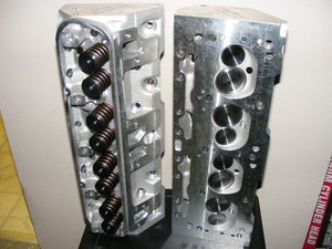

Well it,s time to get to work again!I scored some Eddy RPM aluminum heads from member JD340,thank-you again!car pics 66 Dart 030.jpg

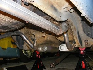

I had the day off today to go see the Dr. and when I got home I decided to start the minitub.I had to pull the rear ofcourse,I,m gonna have to loose the tailpipes nowcar pics 66 Dart 034.jpg

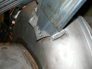

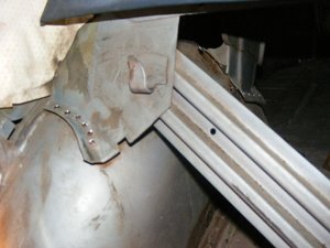

I think drilling out the spotwelds was the hardest job(good thing I,m not 6 foot tall LOL)it gets cramping in the trunk!car pics 66 Dart 038.jpgcar pics 66 Dart 039.jpg

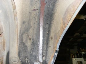

Thank god this car is not all rusty,I didn,t even have to heat up the undercoating in the wheelwell.I just chiselled it with a scraper.It came of in chunky pieces:cheers:car pics 66 Dart 040.jpgcar pics 66 Dart 041.jpg

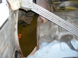

I got the drill and sawzall out and started cutting,I got the one wheelwell out and called it a day(pulling the rear and cutting the wheelwell took 6hrs with breaks)car pics 66 Dart 043.jpgcar pics 66 Dart 044.jpgThat,s it for now,I,m bushed!:stop:Til next time I get a chance to work on it...:clock:

P.S I heat with a woodstove,it sure takes along time to heat up when it,s -10 below.It,s 30x30 block and brick with no insulation.
