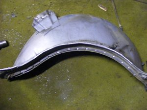

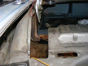

Well today I started on the drivers side,I made some good progress and will have it finished up tomorrow.I,m praying that my spring relo. kit comes in the mail tomorrow also(on vacation this week)I would like to have the kit done and get my rearend and tank back in so I can pull the motor this weekend.I,d like to have the block in the shop before christmas shopping begins LOL.Here,s more pics of progress... car pics 66 Dart 059.jpg

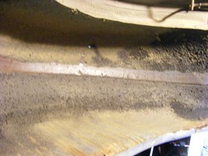

I think the most time consuming is chiseling the undercoating and drilling out the spotwelds!:clock:car pics 66 Dart 061.jpg

Scott and easy way to remove undercoating is with a heat gun and putty knife. Use the heat gun to soften the undercoating and it'll peel off real easy. Wear long sleeves and gloves for sure cause it's pretty hot when it falls off.
She's comin along real nice petty,great work.looking forward to seeing the vids from the track next year.8)
Hey Fishy,I just tap it with a puttyknife and light hammer and it pops off nice and easy!Look Ma no burns!LOL
Ok. When you said "chiseling" it off earlier I thought it might be stuck hard like mine was.
Yes Fishy68,it came of fairly easy.It was messy flying off but alls good.Off to the paint store to order trunk paint by code,then back to welding in the wheelwell.:cheers:
Well,I,m almost done the minitub,just alittle more welding then sealer.I,m gonna cleanup the trunk area and paint as close to the colour of the car as I can get in a spraybomb.I have my fingers crossed that my spring relocation kit comes tomorrow.(were shipped last week).I have to take 2 intakes(1 single plain,1 dual plain)to engine builder to see which of the two flows best with the Eddy RPM heads.Pics...

Well I finished welding up the pass. side,sealed and coated!Now onto the drivers side.Once it,s complete,I,m having a spraybomb made up for the factory blue so it will look all nice.I,d have to say I have about 12hrs. doing the one side(taking breaks ofcourse)HeHe!More to come!:clock:
what did you spray over the welds? and what did you use to fill them in? I used JB weld to fill in some welds that I did in my trunk. and then also put some silicon that was made for metal. But I didn't realize until after i was done that the silicon wasn't paintable :(. felt sorta dumb when i didn that..
you're doing alot of good work here! keep it up! i subscribed so I can get some ideas for my dart :cheers:
I bought some auto seam sealer from the parts store,was $5.50 a tube.Hope this helps.Scrape the silicone off and redo it,then you can paint over it.
