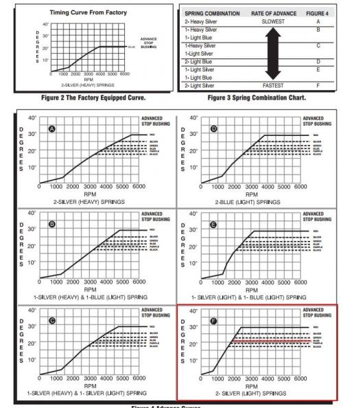

I have a MSD 8388 Distributor - which I bolted on originally with initial settings.
I did not have a clue that the curve would make that much difference.
Initial timing is now around 10 degrees - max 34 degrees.
Have first tried one light blue and one silver light spring - with the blue stop bushing.
This was already a big improvement.
Then I went to the 2 silver light springs - which gave the most improvement - still with the blue stop bushing (21 degree total advance range)
See curves sheet in attachment.
I checked carefully for pinging - and had to turn from 36 to 34 degrees max as it tended slightly to ping in transition from cruise to WOT.
Now it spins the wheels at free will :iconbigg:

Simple test, start car, get it warmed up. Twist distributor at idle a little CCW, if it picks up RPM it wants the timing.
I think you are still short on initial timing. 10* is stock 318 territory from the factory. You have a larger camshaft. Should be in the high teens low 20's. Use the black bushing. Give the car 16 initial with the black bushing and see if it starts OK when warmed up. It should run even better down low.
I still have some 14* bushings as well. MSD missed the mark on not making bushing to reduce mechanical timing.
