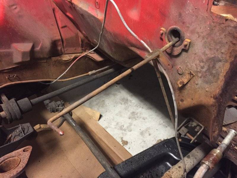

Also, this car had the front end partially disassembled when I got it. What mounts to the two small holes on either side of where the headlight wiring goes through the inner fenders? See third pic below.

Lastly, the bolt holes in the top of inner fenders are for the front splash shields that bolt in from underneath and protect the headlight bucket and parking lights.

I'm also wanting to run all the headlight wires inside the fender so I can eliminate the holes for the wire bundle clips on the inner fender. This should let me fill the ~1.5" hole (where the circular body plug is) that the headlight wiring enters through.

inner fender splash shield bolts to those clips. I welded those holes up on my car, also removed the pinch weld. pinch weld was a PITA

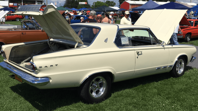

BTW, love the white engine bay with red motor. That’s the combo I’m going to do to.
Thanks, it’s actually an off white, looks yellow in certain light, I believe it’s SS1 - French ivory. This is the car
Thanks for sharing! I'm going for an off white also. With a tan interior. What color is your interior? I'm keeping the factory steel wheels which I plan to paint red (like the motor) and add the dog dish caps.
