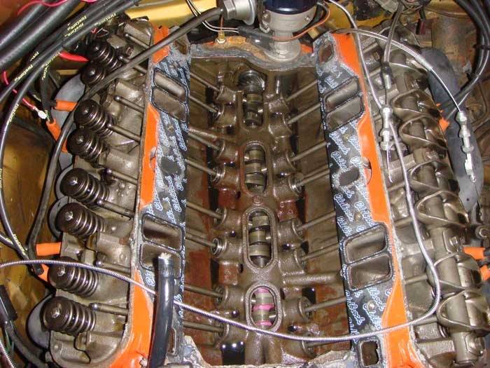

So far... Pulled the valve cover off, everything seems nicely lubed, so I know oil is getting up there. Some of the push rods I can turn by hand, some are tight.

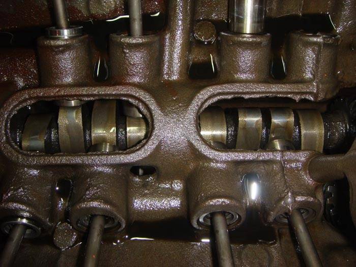

Man?? How do you get that intake off of there? It's cemented on! It's a aluminum intake too, so I have to try to be careful!
I did sneak one lifter out of the head for the #8 cylinder. It looked real good, but as far as any "squish" what so ever, there seems to be none. It don't move at all, real tight. someone mentioned about that there should be some squish.
"they should be hard to push but you should feel a slight squishy feeling to it ....like a high strength spring almost......if you find one that does not give you any squishy feeling,you may have found a bad lifter (either that or a lifter that is just pumped up really good)"
the lifter is hyd...it may feel solid becuse there is oil in it, oil does not compress. Your valves have many pounds of pressure on them, at least 90 with the valve closed.
you are already pulling the intake?
have you checked your pushrods for straitness like I said?
did you check to see if they were rotating when it was running?
Sorry, but I did not. I didn't get your message until I already started tearing everything apart. There is a lot of good advice, yet a lot of the advice is different from other people that seem to get the same result. I was also told not to start it at all in fear that it would just get worse.
At any rate... This is what I have. I was told if the cam was wiped it would be obvious. I guess, I'm just too stupid to tell? :sign10: It does look oddly worn, but it also just looks "used" worn to me!?!? I have posted a lot of pics so I can leave it up to you experts. I am really unsure. The lifters do spin, because you can see the wear marks. I rolled the push rods on a flat table and they seemed fine as well. I do have new Comp push rods I can use when I put it back together just in case. These push rods are from a stock 1971 360. It was rebuilt once, but who knows when.
The lifters have oil on them. I know it looks like burn marks, but it's just oil.
If I shake the lifters I can get them to rattle. They do squish in with just a tap of the finger, about a 1/4" and oil comes out of the hole. All I have to do is shake it and the lifter moves back out. They are flat as well.
IF the cam looks o.k. and I have it this far apart, do you think it might be wise to take off the head, and look at the valves? I have two shops listen to it already, and they both said it was upper valvetrain noise, they used a mechanics stethoscope and they even had a hard time pinpointing the exact problem.
Thanks a lot guys!! PLEASE ADVISE?!?!
im yet to read the post you just made.....but I skipped ahead to the pictures and the cam looked "ok" at first and then I started noticing the odd wear pattern also....hard telling by the pictures....do you have any clearer pictures?.
I dont like that the valley or your engine looks like oil coated rust? they could have did a better job at prepping the block prior to a build.
im thinking maybe lifters and cam though
hard saying by looking at them pictures.....but I am thinking MAYBE lifters are bad? they shouldnt squish in a 1/4 of an inch by a touch of the finger.....they should require alot of downforce to squish them in if the are correctly holding there oil.
normally if I had a lefter that has blead down i will toss it in a bucket of oil and pump it up and down a few times to see if I can bring it back to life...but being that yours are fresh out of the engine I would think they should all still be pumped up.
do you have any pictures of the top side of the lifters?
