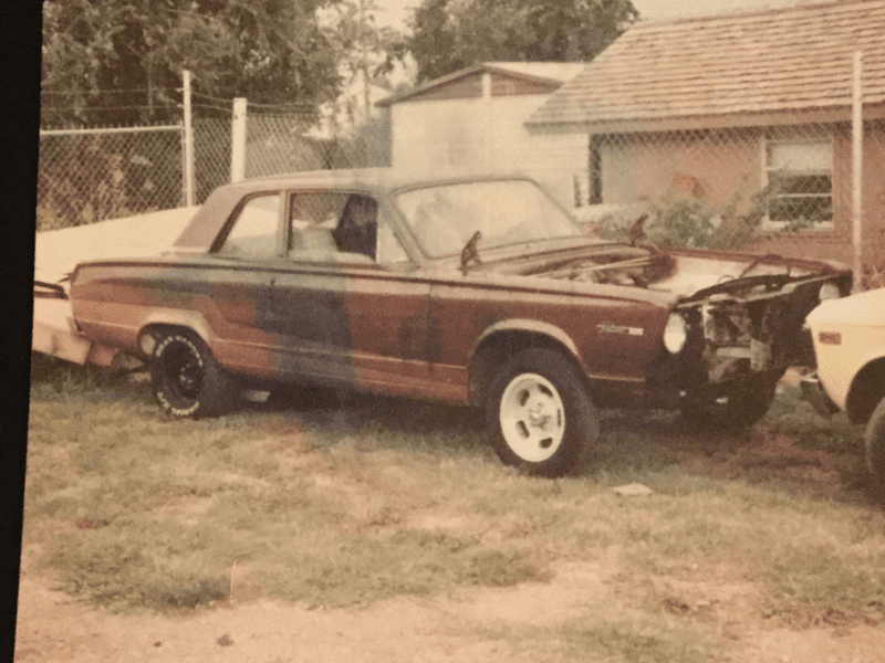

For one, it looked super clean. Its a boxy little two door, and has a neat look. I like boxy little cars, and I can't afford a Nova, so why not? For two, as our hovercraft loving host began to tell me about the Plymouth, my want for it grew. He shared how it was a one owner car, purchased new by his Aunt in 1966, and powered by the "leaning tower of power", slant6. The Aunt, Alene, drove it from 1966 until 1998 when she died. At that point, the faithful little Plymouth was relegated to a series of temporary resting spots (but never title transferred) before ultimately landing in the pasture with what is alleged to be a bent push rod. Adding insult to injury, the passenger rocker was damaged badly when being unceremoniously dumped in its vegetative resting ground.
And there it sat, waiting. As the years went by, the tires went flat, then split, sinking its neat little 13" wheels into the mud where they began to rot. From there, Kingdom Animalia Order Rodentia moved in, and in short order.
And there it sat some more. Through two decades of rain and neglect, culminating in this 25 degree day, and this (yours truly) star struck moron.

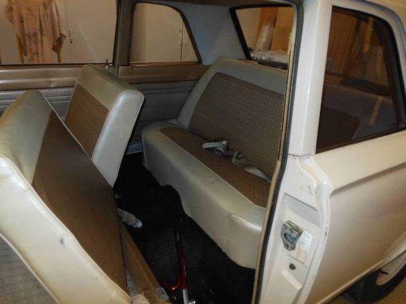

I love those seats! I may steal that idea when interior time comes.

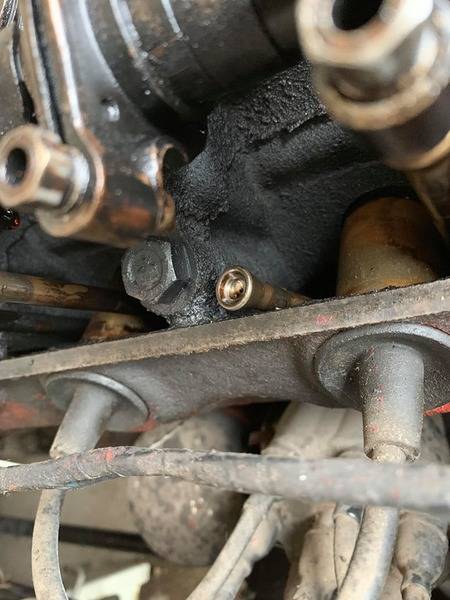

I can't get under it far enough to see, but my hand tells me there is a big hole up there near the accelerator, and since this aint the Flintstones, its gonna need repair. I also unlocked the gas cap and took a sniff. That gas smells like the dead dinosaurs that made that fuel came back to life, climbed in the tank, died again and started rotting. It was RANK. As replacement tanks are only $100 ish, I'm pretty sure I'll not bother cleaning this one. Yuck.

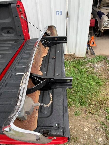

So when we last spoke, I was awaiting a treasure from the depths of booksypacey, a one year only '66 front bumper. I came home one day a month ago to a large surprise on the porch.
I bought this thing for what I thought was a song (since its not repopped, and having one redone is a fortune) shipped. I was really excited to see it. Once open, its nicer than I expected for the age.
Once it came in, I went ahead and ran out to the shop to pull the old one. Man this things beat in comparison.
You can clearly see where someone in the cars former life drove right into something heavy hard and immobile. It was bent to sh*t.
So that day all I did was disassemble the old bumper. Once off, I disassembled the jigsaw puzzle posing as bumper brackets and carried the brackets home to sand blast off 53 years of rust, dirt, road debris and general funk, then repaint. After a good solid blasting, came some primer, then Rustoleum! Much better!
Mounted up. Thought about doing something to the inside of that bumper, but I probably wont.
So this weekend, I head back out. Opening the door, the Plymouth stares at me, mouth agape, as if surprised I finally came back to work. Close your mouth boy, you're attracting flies.
Once installed, it looks SO MUCH BETTER. I will have to do a bit of adjustment it appears.

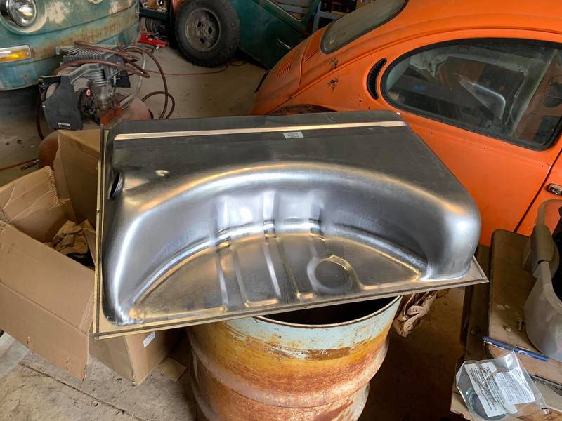

I then moved to the real purpose of my trip out, to check my valves (more on that later) and drop the tank. I have a spiffy *** brand new one ready to go in. I lift and secure the rear, and climb under to release the tank strap and drop the tank. I had been soaking all the bolts ahead of time, so removal wasnt very bad. Once you lower it, you have to undo one fuel line, and one plug to the sending unit. I have been told to salvage the sending unit or at the very least the capture ring holding it in, as apparently the Chineese do not speak "Plymouth Fuel Sending Unit" and have been unable to re-manufacture one that actually sends you any real data. To drop the tank you also have to undo three screws holding in the fuel filler neck as well plus a vent line. All done, the tank drops free. I mistakenly breathe in and am immediately assaulted with the noxious odor of very very old rotted gas. Luckily the tank is empty, save the fumes. Gagging i drag it out and toss it on my tailgate for surgery. 36 brain cells die in the assault on my olfactory senses. RIP ye brave men.
A few tippy taps of the hammer and the locking ring swings free. I add it to the pile of things I need to sandblast and clean up at home. A little prying and I get my fuel sender out. Wow. Guess that is a lost cause too. Plus, the tank is rotted around the hole for the sender. Off to the nearest dumpster you go!
Off to the junk pile with tha lot of ya! So also super nasty and super corroded is the filler neck. I guess i can wire brush this clean maybe and soak it. Dunno, but the only one i found online was $75 on ebay. That buys a lotsa cleaner I think.
So since it looks like this Canadian made jewel will have to wait for another day to go in. Back in the box with ya!

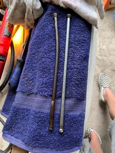

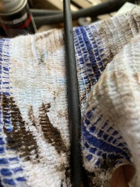

Valve cover off again, lets pull them one by one and see what we have. I have a box of them on standby just in case. In pretty short order, I see that yes, I do in fact have a bent one. Which is odd, because its pretty glaring, and I didnt see that the first time I had the valve cover off. Hmm.
She's bent pretty good Captain!
All in all, I replaced four, with this one being the worst. One had a nick on the side somehow:
But every one of them was covered heavy heavy in oil gunk so i cleaned them each.
The very last one I pull out, clean, go to re install and TINK. Hit something. Try to re adjust, TINK TINK. What the hell? I peer inside, and there lays a bright, shiny lifter. Literally. I have to close one of my aging eyeballs to squint in, and add in a ton of light, but sure as sh*t, there it is.
Bizarre and something I have never dealt with. So i text a buddy just to ask, and hes like "bullsh*t" and I'm like nope seriously, and hes like no way, and I'm all "yes way ted", finally he says, well get that big magnet on a stick and drag it out!
*Facepalm*
Boom, toldja sucka. Lifter. So with nothing else to do, I engage in a very strategic game of reverse Operation, wherein you try to put BACK the vital organs, instead of remove them. Takes some practice, because the center of the lifter isn't magnetic, just the outsides. About 12 min later, about the time my back starts to hurt and I get tired of Operation the game (much like my childhood) it slides home with a very rewarding *SNICK*. Just like that, I'm back in business. I re-install the last pushrod, tighten the valve train back down, and put the valve cover back on. My daylight is starting to fail, and the thunderstorms that have intermittently entertained me all day seem to be getting closer. Two loud cracks of thunder, and distant lightning remind me that im standing in a big metal building with metal tools, and I haven't eaten all day. Time to call it. I still need to set those valves, but that can wait for another day.
