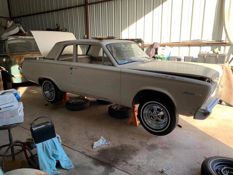

Once home, I couldn't wait to bolt them up to see how they look. I like them! They are quite large, comparatively however, when compared to the stock 13" wheel/tire combo.
It was about the time I was going to install the passenger side wheel that I realized I did not have left hand lugs for that side.
Crap. Stocks back on, lugs ordered. BUT for that one brief shining moment, it looked great! Like a bit of old dead skin had been peeled away to show the bright pink new life beneath. These tires are a bit large, and may not make the final cut, but I will get them all mounted and see exactly what I am working with, when the lugs come in.

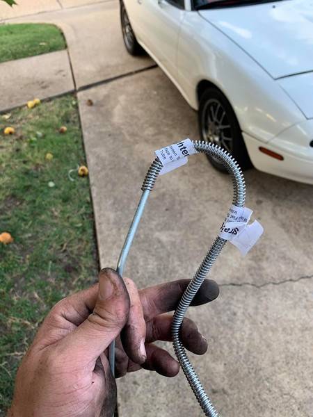

First thing I did was make sure the fuel line was clear. Mo gas, mo air, mo crap sprayed out. That line is clean, so let's move on.
So I kinda got clowned by my buddy when I bought the actual fuel tank pad instead of just using some cast off tar paper, but since this was like $18 and I didn’t have any cast off tar paper, and I didn’t wanna go bumming around for cast off tar paper, and I had $18, I didn’t worry about his opinion much. Also, Detroit Muscle was easy to deal with and shipped quickly. Here it is lying "in place" prior to glue. Fit pretty well, and is notched where you need it to be. I had to lay it out in the sun for a while so it would quit its rolled up ways. Other than that, no issues!
Quick note, the aftermarket ring that comes with your fancy Chinese fuel sender is made of grade A hot stinky garbage. It was too small, didn’t fit in the hole, barely fit around the fuel sender, and is 100% effective at ONE THING, and that’s pissing me off. So if you feel the need to be pissed off, and don’t have a ready target, buy (Edit: don’t buy this, ever) one and smash it with a hammer. Twice. So I, having the brains to keep the old one, walked over, put it on the wire wheel and, for no reason, painted it.
Now we in bidness!
Sender goes right back in like its supposed to when you use the correct part. Funny that. So using the powers of my knees, minimal big swears and only a pinched finger or two, Madam Valiant of the isle of Plymouth gets the gaping hole in the rear filled with one shiny fuel tank. And it fit perfect!
