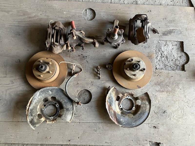

I’m in NE PA and I have a K/H disc setup from a 69 cuda
Spindle, dust shields, rotors, calipers,
Caliper bolts, ball joint bolts
Calipers would need rebuilding
4” bolt pattern
If you’re interested I can send pics and pricing. PM me
