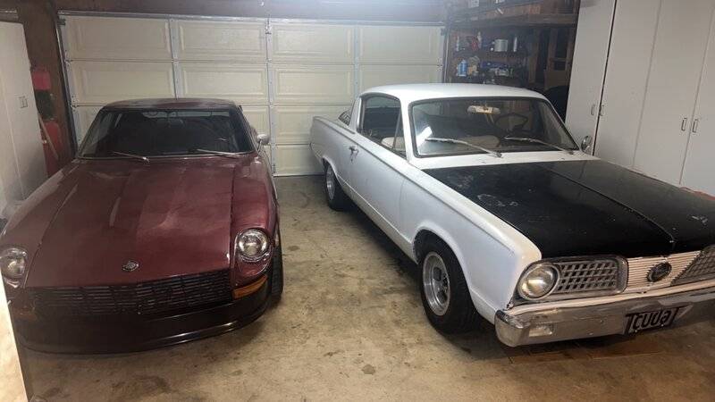

Not on topic, but how come your 66 B-Cuda dosnt have the turn signal indicatotrs on the front fenders,???. Do you have dash indicators,???. Just curios.
Dave

Shaved off this was a movie car from San Bernardino CA I pulled out of big bear. I don’t have the indicator on the dash, didn’t know there was one.

Their are no dash indicators on a 66 B-Cuda, They didn't have them, just the fender fins, which are like hens teeth to find, along with the wiring. You could install a couple of LEDs in the dash, (the kind with the long wires attached) if you wanted too.. then just tap into the appropriate wires down under the steering coloum. Just a thuoght.
