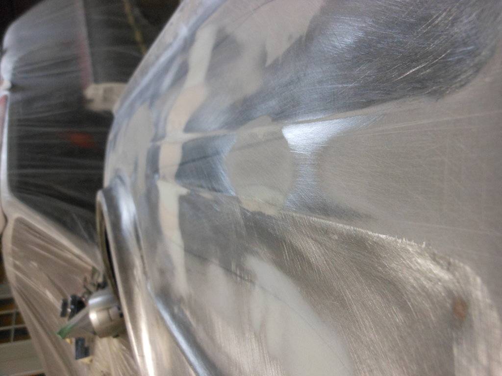

Ive been working on the front fenders of my 66 dart on and off for 6 weeks. Im no farther ahead tonight then I was at the beginning. Problem Im having isnt making surface smooth but its creating or should I say recreating the body lines. Heres the history, My dart is a 270, it had a body trim that went from front to rear about 3/4 of the way towards the top of the fenders and door and rear quarters. Ive removed them and will not be using them again so I had to weld the holes that are in the body to hold trim in place. Here is a pic of the fender.
Above the center between the 2 indents are the biggest issue. There are 3 places that you can see I have put filler into. My issue is remaking that body line both top and bottom. First I am struggling to find the exact line to follow. Ive been trying to stretch tape along the old line but its very hard to see that exact line since the line is rounded toward the indents. I can make the indented area flat but im struggling to then match the rounded body line to the flat area without going to high into the center area or to low into the flat indented area. I feel like all i do is make filler and sand it off and repeat! I tried using 180 grit and also 80 grit on sanding blocks both flat and rounded ones.
Above you can see I have it somewhat filled in but it was to low at the flat area of the indent. Below it looks like I have body lines but they werent straight. Any suggestions on a good method would be greatly appreciated.
I want to do this myself and not have to pay someone to do it but so far I am going nowhere fast!
Thanks Rod
Not meant offensive or smartass at all, but what stands out in my opinion is the lack of patience and the use of flat straight sanding devices.
It looks like too much filler material is being taken off to aggressively.
Trailbeast, not taken as a smartass comment. I appreciate your advice. Im not using just flat blocks tho. I said in my first post I have used both round and flat blocks. What do you recommend for paper? Ive tried the 80 but as you stated it seems to fast and the 180 seems to clog and doesnt cut as evenly. As for lack of patience you are right there. I havent had enough time to dedicate to the job and since I am unfamiliar with body work it is frustrating putting on and sanding off.
Thats the reason I posted and Im hoping someone will give me some good advice to follow so I can see headway.
Rod
Find a piece of foam pipe insulation that closely matches that concave curve and the corresponding piece of pipe for some backbone. That's your new sanding block. Long strokes from end to end. On those inside corners cut a short piece of the insulation and use it without the pipe inside. Where you place your fingers and the pressure you apply to each one will effect the result.
Also know when to say good enough. Nobody (including yourself) is ever going to stare at it this hard ever again.

PA scamp said something that I think is important enough to point out again.
Don't try to work spots, but work the entire length of your lines at once as evenly as you can, and plugging up paper is kind of a given if you work filler too soon.
Try filling and then waiting until you can get to it again if you can't give it a good couple of hours to set first.
Also, if you get it real close, try using some finishing putty for the last little bit of shaping. It sands very smoothly with 220 grit dry paper. If you lived close to me, I'd come over and help.

A couple observations, you could use tape to establish your lines uniformly on both sides. I use a sanding product called Abranet with blocks through 400 and block with 800 up wet. Use guide coat. It looks to me like you are ready for some epoxy primer too. Don't press too hard on your blocks. And lastly, a year from now even you won't see it.
Best of luck, you are doing good work.

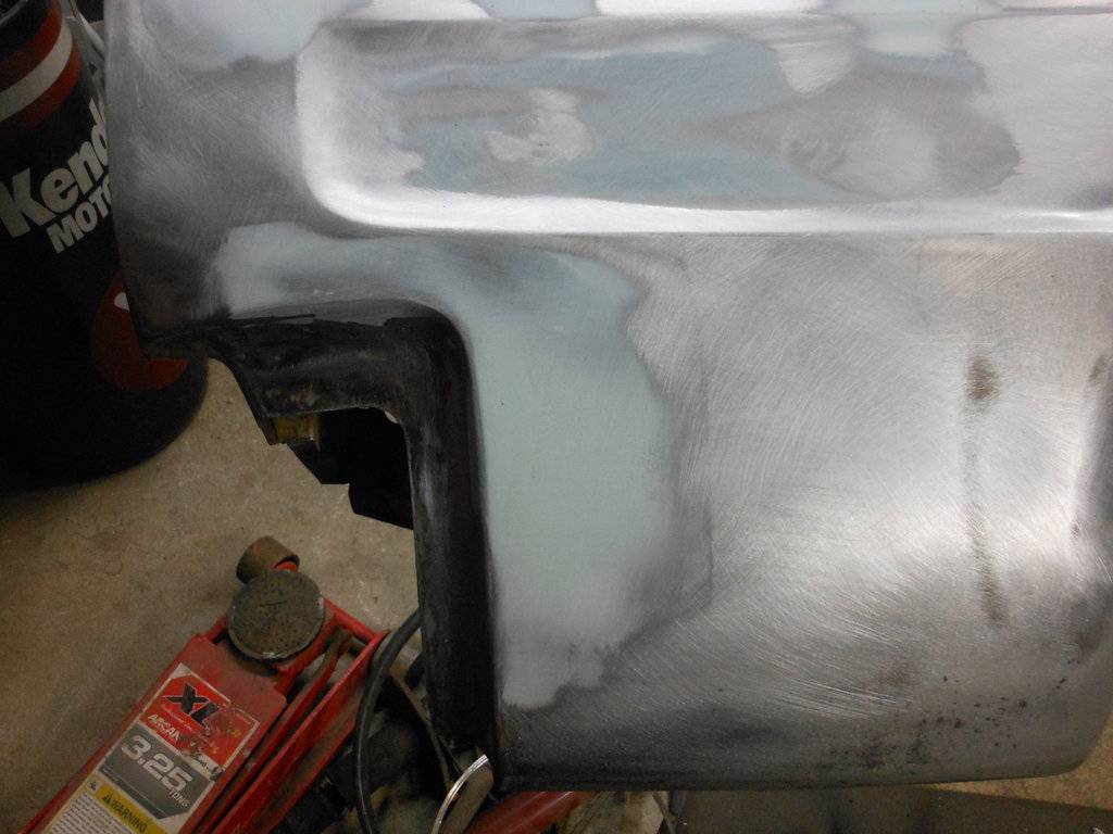

View attachment 1715083200 Above you can see I have it somewhat filled in but it was to low at the flat area of the indent. Below it looks like I have body lines but they werent straight. Any suggestions on a good method would be greatly appreciated.
Thanks Rod
You're taking too much material back off. Work the front half of the fender as one piece. Coat the whole thing. Work the the higher section, flatter parts, then tape off the scallops and work the lower part/scallops. While sanding if you hit metal it's a high spot. Stop and recoat. I stay with 80g until I'm very close then skim coat with metal glaze, a partial knockdown with 80g to "de-skin" the plastic and onto 180g. Using too fine a paper too early will only waffle it up.
That's a pretty intricate piece for a newbie to tackle. I've been doing it for a long time and still use guidecoat on filler and tape bodylines to watch what I'm doing. I also start cutting when the filler is still a little soft as it speeds up the process. The quality of filler can make a difference. Some shrink and you can really chase your tail trying to make stuff nice.

First let me say thanks to so many people that replied back to my post. Many great suggestions and tonight I went back to work on it. I think things went very well tonight as I had a different mind set to attack it with. So here is where I finished up tonight.
I spent 1 1/2 hrs tonight and felt as tho I made more progress then all my other nights combined. The biggest thing that kept running thru my mind tonight was to not rush it, dont take off to much at one time. So I sanded with a lot less pressure and was in no hurry and I think I made good progress. A few people threw out that need for primer last night. So my question is am I ready for primer? Also someone mentioned using an epoxy primer. Do I spray that before I used a high build primer or after. Last fall after I sanded the entire car to bare metal I just sprayed it with the high build primer. Now Ive had it covered with plastic since then but I did not use an epoxy primer on it. Does the high build primer have a shrink factor and how long after I spray that can I sand on it? If I need more filler once primer is on do I need to sand first or just apply on top of the primer? How many coats of primer can I put on and how much fill will it do because the 80 grit leaves sand marks. DO I sand with 180 before priming?

My method is to put epoxy primer down when I have the body work close. I prefer it as the base coat.
Then I start blocking with guide coat and using mud where needed and topping it with high-build primer as
the work gets closer and closer. Lastly, a little glaze if needed and a good coat of sealer just before color.
It's not right or wrong, it's just the way I do body & paint.
You are on the right track and you want the right coating on that bare metal. I'm sure you will get other
input which may vary. A lot depends on your paint vendor and your budget as well.
