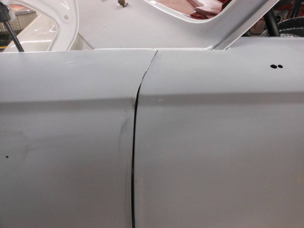

I went out to hang the drivers fender tonight and heres what I have. Now its not close and I am going to need some suggestions on this. The fender is as far front as it will go. The bolts are at front of the holes and hitting, the fender at the top at door over laps the door by at least 1/8". SO what do I do from here? Grind the top of the fender back? make more room for bolts to adjust forward? Split grinding between door and fender?
Heres pics
Heres pics
View attachment 1715130874 View attachment 1715130875 View attachment 1715130876 View attachment 1715130877

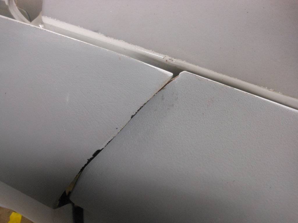

How is the gap where the door meets the quarter ? Always start with the door & quarter gap & work your way forward.
Here is the gap behind the door. Its a very small gap. These are the same body parts that came off the car. Just over 1/8". Im puzzled.

View attachment 1715130998 View attachment 1715130999
Take all the bolts out of the fender and leave one that will give the ability to move the fender forward and workable.
Did the fender bolts feel like they were in a bind or an angle when you removed them?

Raise the fender up so the lines on the side meet. That should open it up at the top of the door where the fender lays back towards the window post. I wouldn't grind the edges of the panels you'll end up going through. Not much meat there before you split the skin from the door or grind a hole in the fender. Hard to tell what you have going on there without standing right there.
Here is what ive encountered in the past. When I took fenders off of cars & laid them on the floor & they laid there for some time I had fitment issues. That's why I always hang my fenders. Just a thought. Are they the original quarters ? Ive always used a wooden paint stick for a gap gauge. About 3/16
Here's what I found out, the top of that fender had about 1/8" or more of idler extended over the back that I hadn't sanded off when I did my work on the fender while it was off the car. Kinda embarrassing to say! Now it still needed to go forward a little and I did end up opening the holes up some on the fender. I'm hoping this weekend to get the other fender hung along with the hood so I can align everything together and lock the fenders into place where they need to go. Again thanks for all the help here. I can't tell you how embarrassed I was when the old-timer came over the other night and he had me grind a little from that fender and I found the filler! Oh well, it's not going to be the last stupid thing I'm going to do.
