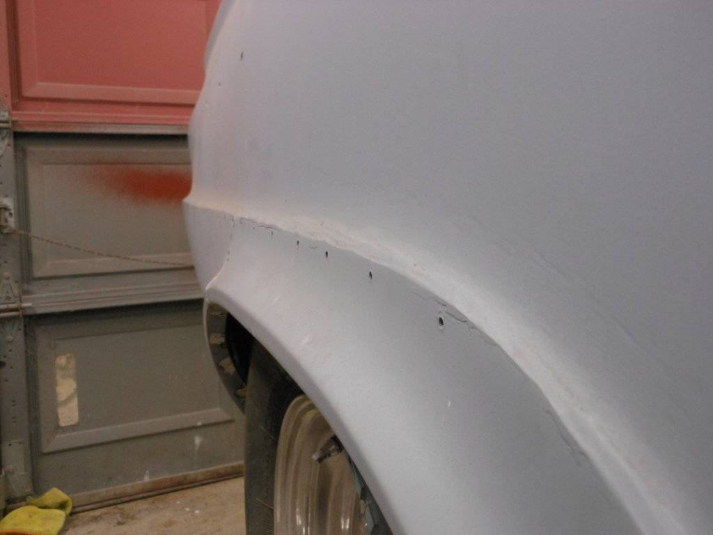

Finally got some work done and decided to put primer on the fenders and doors. Im really happy with the doors. Heres a pic just after they were sprayed tonight.
Here are some close ups of the problem on the scallop area. You can see it on the 2nd fender pic which is the drivers side. Here are some close ups of them.
View attachment 1715127253 View attachment 1715127254
I have an old body guy coming tomorrow night to take a look and give me some helpful hints on best way of going about cleaning that up. (I Hope!)
I think im very close just need to get it a little closer. It looks to me like i didnt bring the line quite far enough on both fenders. Im hoping its an easy fix. But the good thing is that all the holes I welded look very straight to me and the area that I had to cut and put metal in the fenders looks good as well. Theres just on spot on the one fender lip I need to make a little nicer. See pic below
Your suggestions and comments are more then welcome. And as always thanks for following and helping me along,

Nice Job, that front scallop can be a monster to finish. I spent a few hours fine tuning the scallops in mine after removing a dent or 2 down by the bumper area. body lines are usually the hardest to finish the way you would like them but your is pretty good except for those few defects. once those are done you's be ready for even more block sanding..:thumbsup: here is mine of the 3rd block sanding venture. or maybe it was the 4th.. anyway it was a LOT!

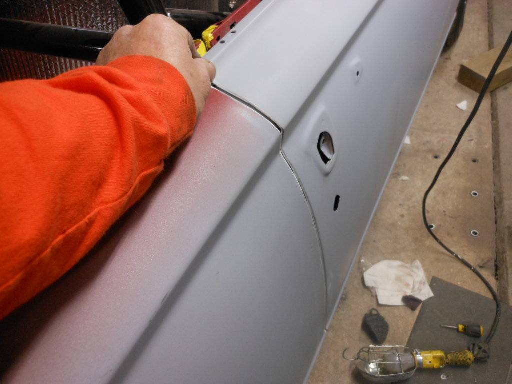

The hinges are as far forward as they can go. The bolts are against the body holes on both top and bottom hinges. But why are you thinking going forward to solve the latching? I understand for the gapping you would move forward.
Now heres another thing I forgot to say is that the latch has .240 of shim behind it on the body jamb side. But my problem is with going in to far before latch not front to back. Im confused with this alignment!
Heres some pics,
You can see that the door fits really well in this pic but it is not latched tight here.
Heres the pic where the door is latched and you can see how far it is in. My issue is the latch wont come out any farther.
Again I cant get the door to move any farther forward to make a larger gap. This photo makes the gap look larger at the top then the bottom by a lot but its not as bad as it looks. Thats some of the latch moving the door as its in so far.

Remove the striker completely.
Slightly losses the top hinge and the bottom and gently open the door and let rear com down about a 1/6 of an inch...it won’t take much because if you multiply 1/6 x the length of the door that’s a lot...then gently shut the door and Check the gap. If it’s good...tape the door closed and go around and tighten at least one bolt behind the dash and kick panel. Then retest by opening and closing gently and adjust the same as you did on the drivers!! Once your happy with all you gaps and fit...put the striker back and keep testing until it opens and closes with very little effort.

Sometimes the strikers need a little persuasion to get them to move outbound. It's a caged nut inside the pillar. I use a slide hammer with a U-shaped attachment to move outbound. Loosen striker, tap, tap, tighten. Sounds like your only getting the first safety latch not the secondary full closed position.
