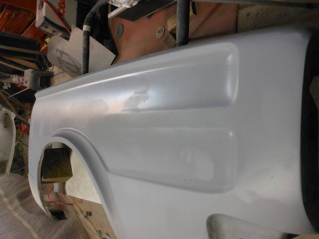

Ive been working on the front fenders of my 66 dart on and off for 6 weeks. Im no farther ahead tonight then I was at the beginning. Problem Im having isnt making surface smooth but its creating or should I say recreating the body lines. Heres the history, My dart is a 270, it had a body trim that went from front to rear about 3/4 of the way towards the top of the fenders and door and rear quarters. Ive removed them and will not be using them again so I had to weld the holes that are in the body to hold trim in place. Here is a pic of the fender.
Above the center between the 2 indents are the biggest issue. There are 3 places that you can see I have put filler into. My issue is remaking that body line both top and bottom. First I am struggling to find the exact line to follow. Ive been trying to stretch tape along the old line but its very hard to see that exact line since the line is rounded toward the indents. I can make the indented area flat but im struggling to then match the rounded body line to the flat area without going to high into the center area or to low into the flat indented area. I feel like all i do is make filler and sand it off and repeat! I tried using 180 grit and also 80 grit on sanding blocks both flat and rounded ones.
View attachment 1715083200 Above you can see I have it somewhat filled in but it was to low at the flat area of the indent. Below it looks like I have body lines but they werent straight. Any suggestions on a good method would be greatly appreciated.
I want to do this myself and not have to pay someone to do it but so far I am going nowhere fast!

the defining lines on the 66 is a hard part to get right. mine was in the bumper recess area(dented in @ pic #2 and the top body line that someone had dented down midway in the body line with what looked to be a rounded ballpeen hammer ) I spent 3 weeks getting rid of a slight curve on the rear section of the rear lower patch panel and then realized that it was supposed to be in there! took 3 solid days of metal stretching to get it back in @$#%%$ DUH moment.

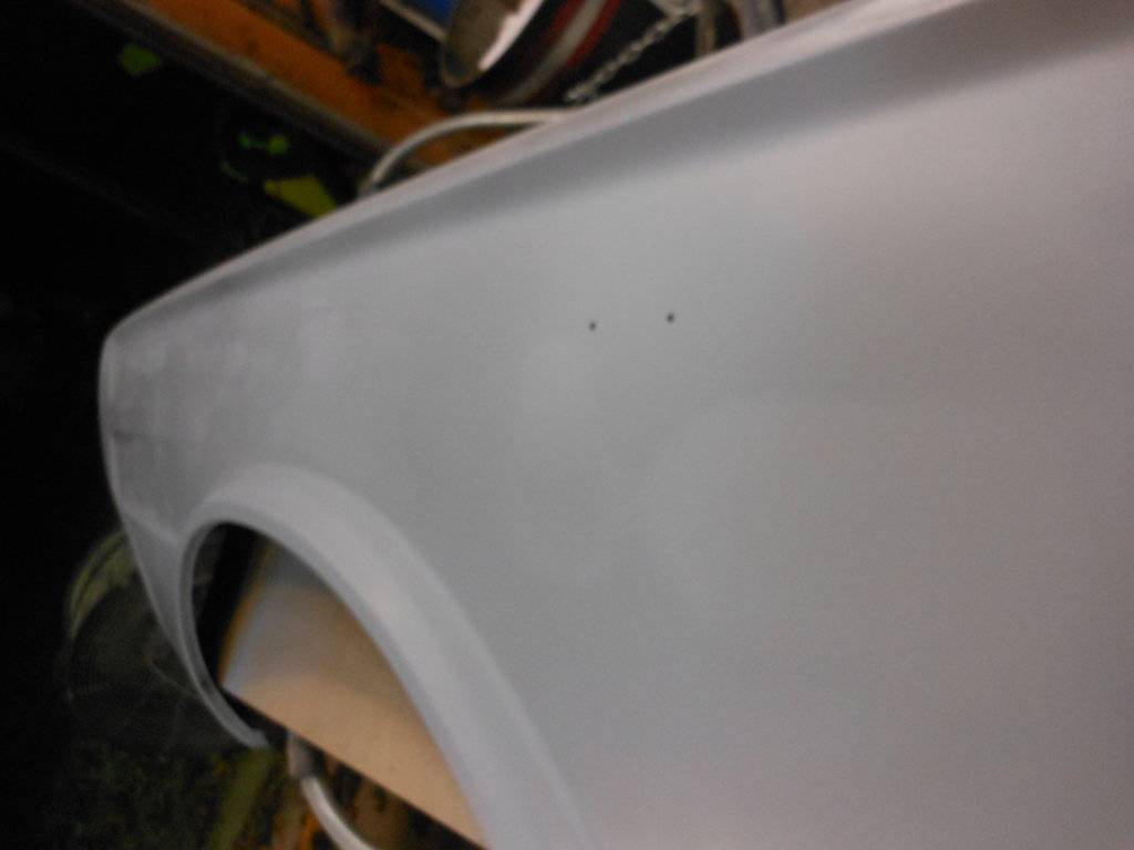

Had an opportunity to go out last night and do a little work. I decided to throw some primer on the front fenders just so I could see what the lines looked like. Here are some pics of each fender. Im not satisfied with the lines so Im going to try to get them a little straighter and a lttle more level. I can see that the holes I welded were still a little low.
Here is the passenger side, the one thing I see is each spot that has filler on it bleeds thru the primer. Its only one coat but is this normal?
Now here is the drivers fender. same thing I can see a bleed thru of each spot that has been repaired. The lines are the only thing i was not happy with. I think the other holes that were welded and repaired are good.
Now I must tell you these fenders were only sanded with 80 grit so far. I guess now as I go forward I will need to go to a 180 grit. Maybe thats the reason that the repaired areas look the way they do? Also i wasnt real concerned about dirt so I didnt clean before I sprayed figuring I would need to sand anyway. I was just trying to get an idea about where I was going to be in the repair process.
After I was done I did a quick soft sand across the line area and found that I had low spots so I put a little more filler on the entire center line area and left it sit over night. I will try to get time tonight to address that area again and see if I can improve that. Let me know your thoughts and where you think I should go next to make this better.

not bad at all! stick to it - you're getting there. Hey G @GeorgeH --- whatcha think?
Once you pull out the primer,80 grit goes away. My body shop guy works with finer paper all the time. Especially the glazing putty, which is now 2 part like filler. I tried sanding it, coarse paper hardly marks if, but 220 makes dust.
He also uses tape lines, fills up to the tape and blocks it off.
And only sands cross-hatch.
Hard to tell from the photos but the lines look pretty good for where you are at from here.
Use tape and high build primer, cross hatching progressively finer paper until you get what you want.
Truth is, you will never be truly happy with it, doesn't happen in body & paint---------------:-)

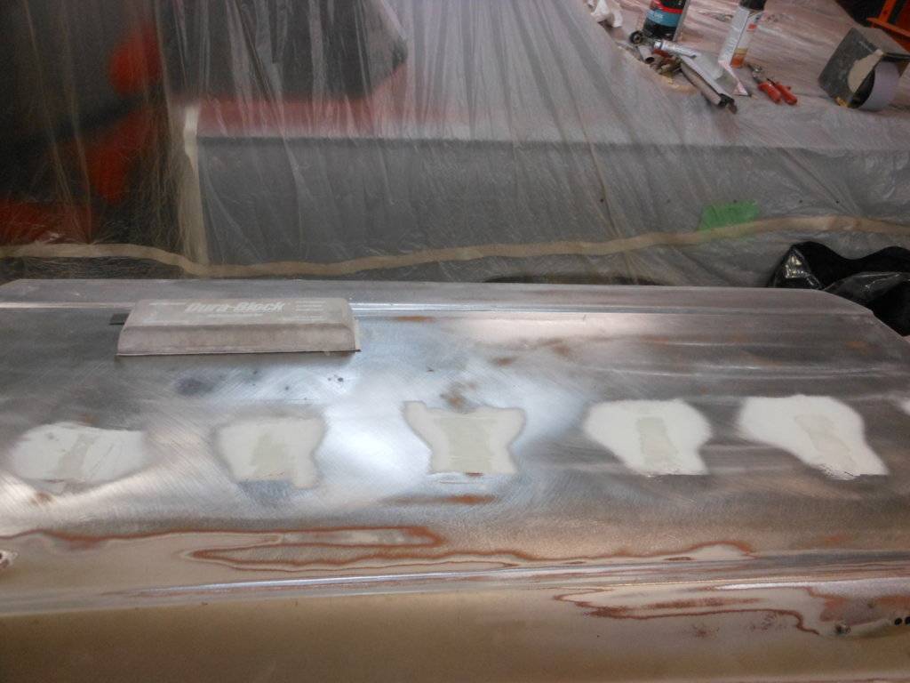

Spent some time hopefully completing the fenders to the point I should start spraying primer builder and blocking it down. Its not perfect but I think I will be happy with it. This body work stuff is tuff work!
Now i'm starting the doors. Same thing on the skins, I had to weld the trim holes shut.
Once that was done I took the grinder and ground down to surface. Then I took some filler and spend across the door so I could see where I stood as for high spots and low spots. Here is where I am at after sanding off the filler with a 11" block and using 80 grit paper. As you can see each spot I welded appears to be lower than the door skin so hopefully I wont have any high spots.
Now the question is how should I attack this so I get a nice smooth skin. This will be the same thing I will encounter on the rear quarters when I get to them. The front fender wasnt quite this way as it had more curves that hid any uneven surfaces.
Looking for some good advice so as I go forward i'm not wasting time reworking my work!
