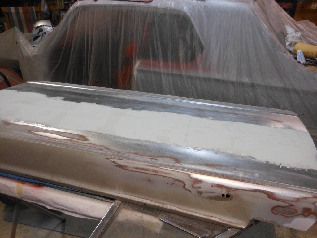

Spent some time the last 2 nights working on the door. Here are some pics of what I am encountering. Not sure I am doing this correctly.
After the first layer of filler and as seen in the previous post I laid down a solid 6"-8" wide filler application. I tried not to get it to thick.
Getting ready to sand some of this. I am sanding using an 11" block with 180 grit to start. Once I get it fairly smooth I switch to a 180 grit.
Below you can see where I am at after doing 3 coats and resand. Trying to use a different color each coat so I can see when i get tot the previous layer.
Heres where I stopped for the night. It feels very good but I have to do a thin coat using a glazing putty? there are a few scratches that need filled. My question would be how thick do I apply the glaze and how do you tell how thick you are putting it on. how far above and below the previous filler do I apply the glaze. Trying to learn and do this the correct way.
Thanks for any advice you can throw my way.
Rod
If it was mine I would be hitting it with guide-coat spray and working it with #400 and a long block to see what the guide coat told me.
Glaze does not build so you only want to use it as a last resort for the smallest defects before final sanding and priming.
JMHO-----------Rat----------:) good luck!

It looks like you are ready to put a first coat of primer on it now. Be sure to use a good degreaser first.
After primer, guidecoat and either 240 or 400 depending on how close you are to final.
Just before the last coat of primer when you have it as close as you can get it with 400, then use the glaze
to clean up small imperfections.
You just need to get it close enough for a high build primer (which is fairly close).
Careful blocking of the primer is what makes a car straight.

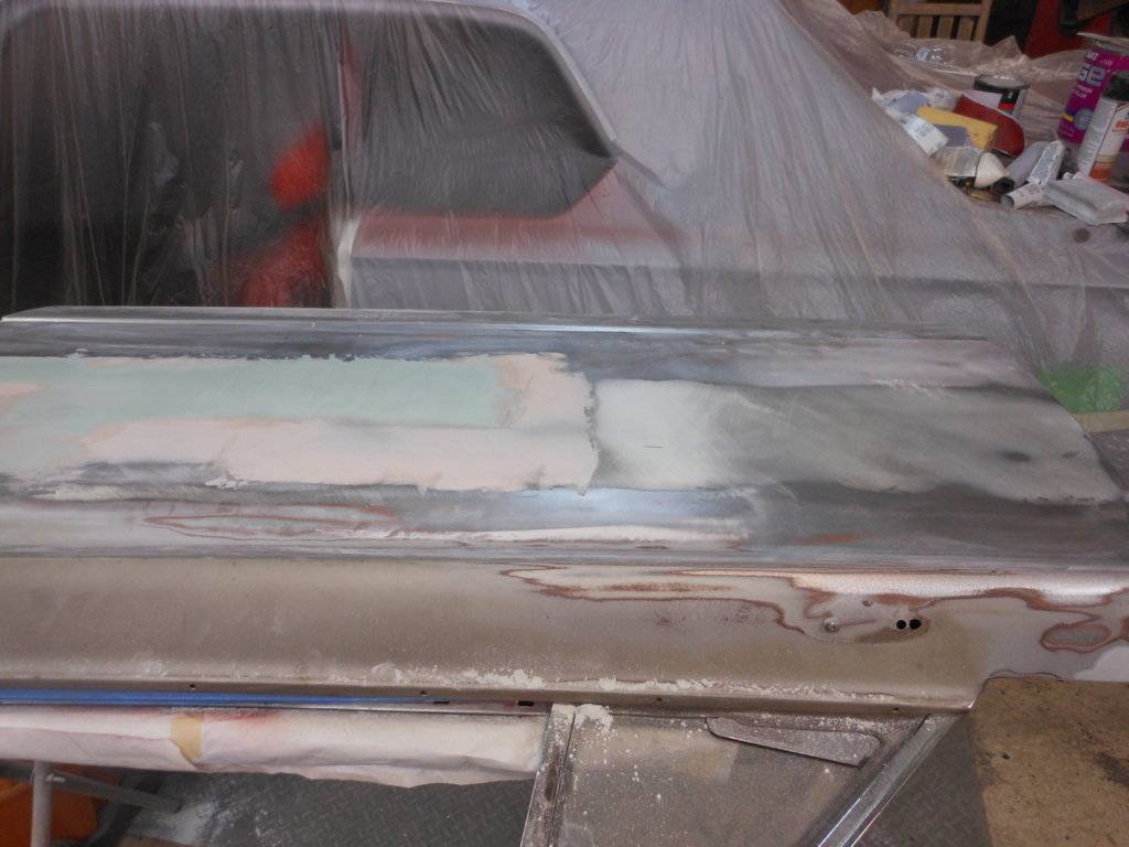

View attachment 1715108829 Below you can see where I am at after doing 3 coats and resand. Trying to use a different color each coat so I can see when i get tot the previous layer.
View attachment 1715108831 View attachment 1715108832 View attachment 1715108833
Rod
Typically I hit the first coat of plastic with 40g on a long board or air file., then sucessive coats with 80g all the way up until it's straight. Then skim coat with polyester glaze and switch up to 180g. If you start blocking too early with 180g you start to waffle it back up. When it gets to the final coats of plastic coat and work the whole area each time. Putting a little swipe of filler in the middle of it and sanding it makes it worse. Do you have a long board?

Dura blocks are ok depending but I prefer an old school wooden/aluminum board. The longer dura blocks can be flexible. Ok, I seldom have to apply more filler over primer unless it's just a pinhole or something. When you work an area coat the whole section. When blocking when you first start to see the underlying layer whether it be metal or the next layer of filler down that is when you stop and recoat. Filler is cheaper then primer so I usually stay with that and I don't really like a layer of something different in the middle of the filler work. In my experience depending on the filler used some like to shrink overnight so once I get that first prime on I like to let it sit for a day or 2 or longer and re-block and prime again.
