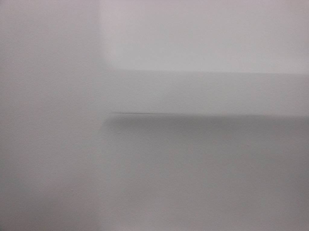

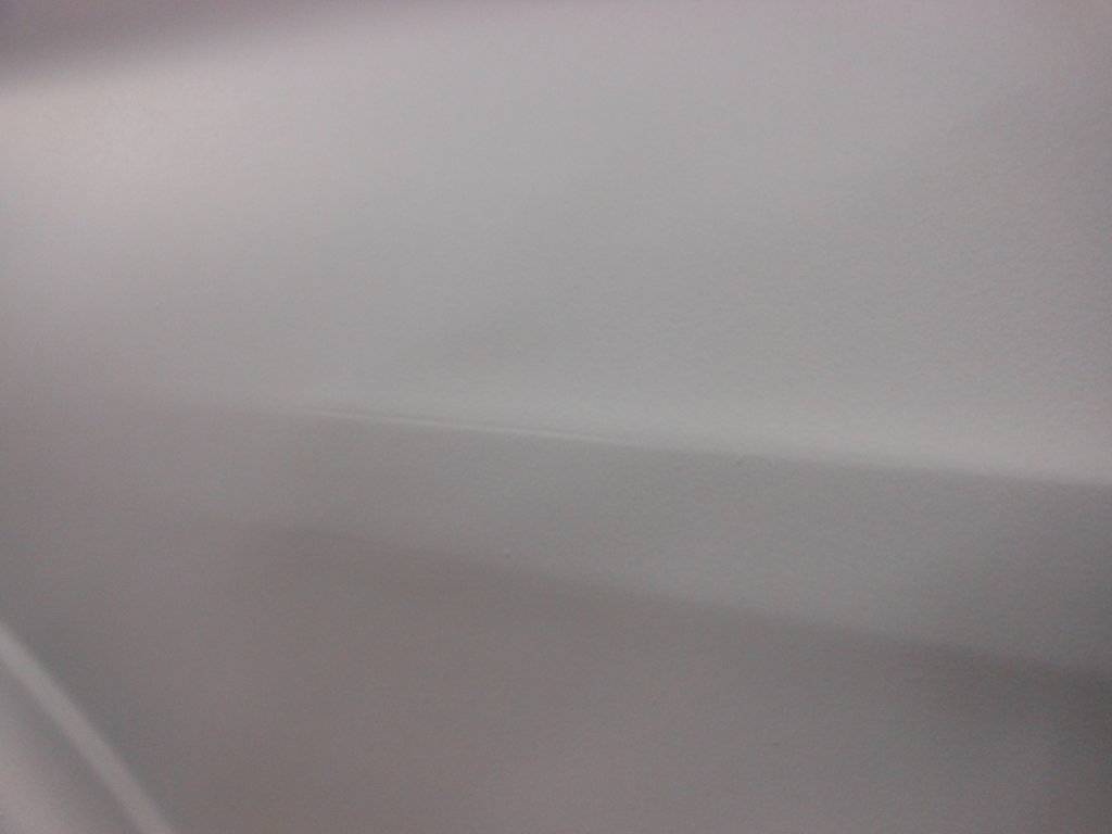

Got to go back out and start some more work on the doors tonight. I noticed where the door mirror bolts to the door the area appears to be dented. Here are some pics.
I know its hard to see but above you can see just below the 2 holes, the area that appears to be dented down. I am assuming thats not the way it was from new and I need to pull that area up and make it match the rest of the upper side of the door? Also the single hole will need pulled up slightly as well.
View attachment 1715120561 View attachment 1715120565
So does this area need work or is this the way it is supposed to be?
Thanks Rod
Stud gun is really the best option. Absent that pull hooks. It doesn't take much to move that area. If you just have to fill it, I would put a 1st. coat of fiberglass reinforced filler on there. used to be able to a pint can under the Bondo-hair label in Advance or Auto Zone.

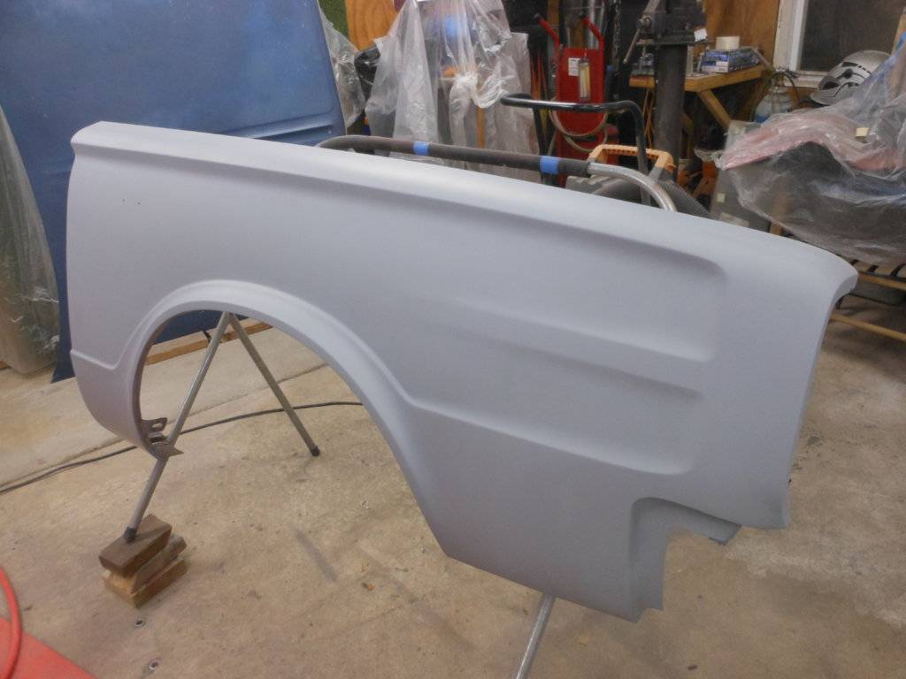

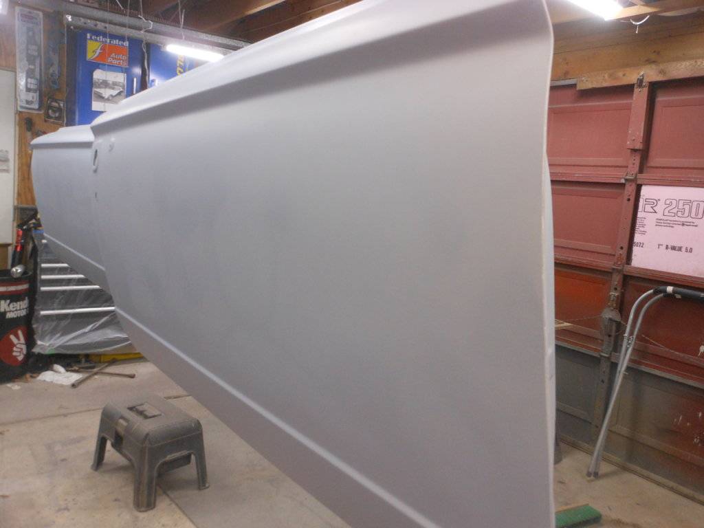

Finally got some work done and decided to put primer on the fenders and doors. Im really happy with the doors. Heres a pic just after they were sprayed tonight.
I plan on doing the jambs on the doors and hinges this weekend then get the car back into the shed and put the doors and fender back on the car so I can start to fit the car together.

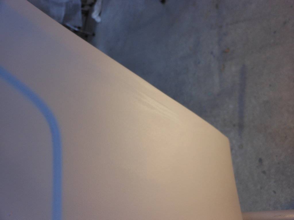

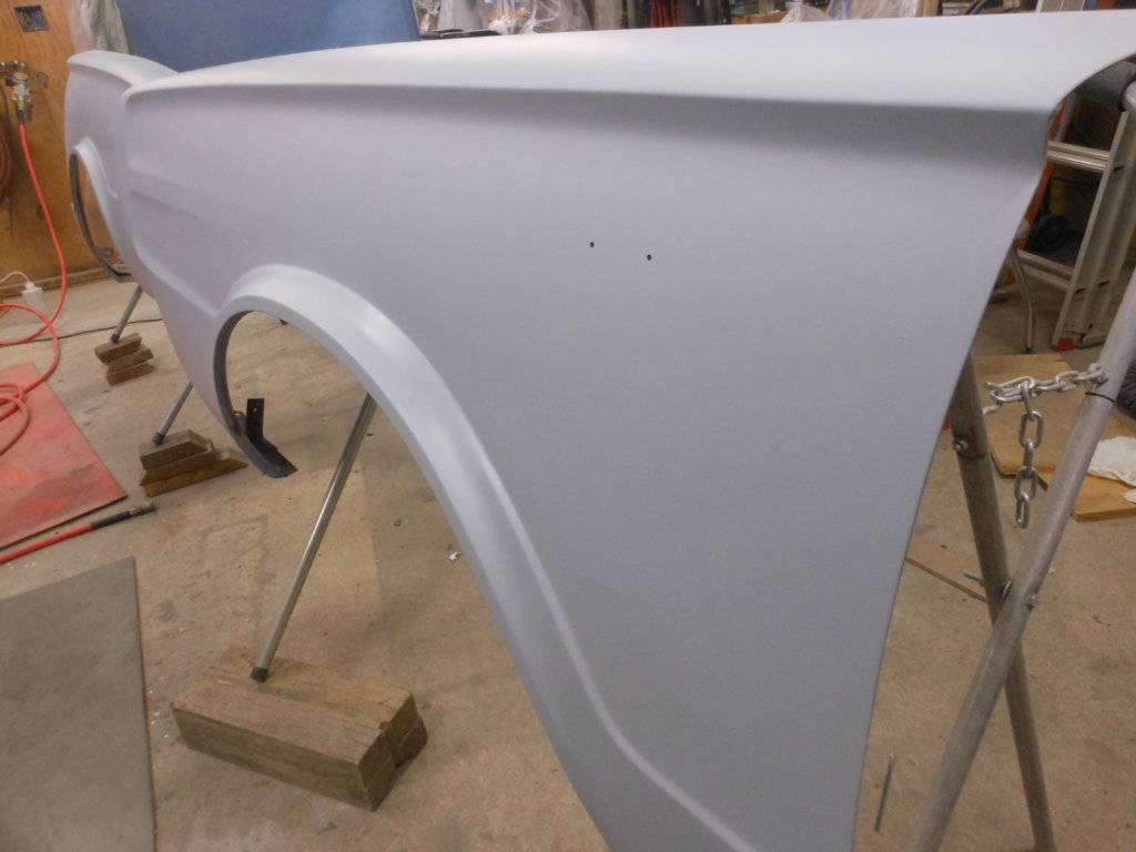

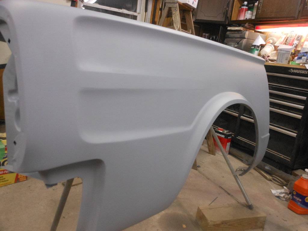

Now the fenders are straight but Im still struggling with the scallops on the front of the fenders. Here are pics of them.
Here are some close ups of the problem on the scallop area. You can see it on the 2nd fender pic which is the drivers side. Here are some close ups of them.
I have an old body guy coming tomorrow night to take a look and give me some helpful hints on best way of going about cleaning that up. (I Hope!)
I think im very close just need to get it a little closer. It looks to me like i didnt bring the line quite far enough on both fenders. Im hoping its an easy fix. But the good thing is that all the holes I welded look very straight to me and the area that I had to cut and put metal in the fenders looks good as well. Theres just on spot on the one fender lip I need to make a little nicer. See pic below

Hey Rod, Just a note. I think your doing a great job based on the photos. Like George says, a little fine tuning. There are all sorts of videos on youtube that show how to use primer surfacer and guide coats (blocking). This technique works very well for getting away from the "wave." This may help you, guide coating and blocking is tedious, but the end results....you will be very happy. Best. Old Dart 66.
Just remember, if the metal is flexing while you are blocking, you are making waves. Let the paper do the work.
You will likely need to prime and block several times.

Hey 68, excellent point on the metal flex.....I should have mentioned that in my response....soft easy multidirectional strokes, and yes, let the paper do the work, and just to be on the same page, and not at all critical, I use PPG-K36 primer/surfacer. Blocking out primer would be a chore.

Hey Rod, It is not so bad...really. The sanding work, yes, is tedious, but the reward comes in the end. Careful though. Not to frighten you, but the flaws show up when the base coat clear coat go on. I block, guide coat, block guide coat, over and over using a quality primer surfacer with an appropriate wipe down between each coat. A good trick is to spray your panels with "clean" water, using a good light on the surface. This mimics the clear coat, and the imperfections, if any, will show up. Of course, you've got a good body guy coaching you on site. Keep up the good work. By the way, using the longest block that you can on any given panel is a plus. I know, those 66 fenders have a lot of detail.....been there, done that. Best. Old Dart 66

Yes Rod, After guide coat blocking a number of times, I use a clean clean clean, such as a Windex spray bottle, and I apply a few squirts of clean water, then I wipe the panel down with, for example a clean dry dish towel which applies the water evenly. Kind of like the pavement on a street after a light rain at night giving a bit of a shimmer. Then shine a light from behind you....using a lamp, and the panel will shine like it has a coat of clear coat on it. This technique will expose any waves, nicks, or low spots you may have missed using your guide coats. You are aware of the definition of a guide coat being a light mist of a fast drying spray bomb paint which is compatible with your primer surfacer.....so you do not develop any lift, and that the mist will adhere on the low spots and can be painted over with the next coat of primer surfacer. Again, using the longest block that you can, given the panel, you will be able to see the low spots by the mist spray that is left behind. I use my eye, my feel of the hand, and the guide coats, primarily. My final test is the water mist where I am looking to confirm that I have the panel as true to whatever ambient light the car will be exposed to....from bright sun, to a night time street light. Believe me, the water trick will tell the truth on body work. So far, no complaints.....soooooo far. Check out the YouTube channels on blocking. Now is the time to do it....especially with all of your hard work and the $400.00 plus per gallon base coat....and then add the clear coat cost. Hope these thoughts were helpful. Looking forward to your final photo in the "sun." Best. Old Dart 66.
Rinse the panel and stand back and look for waves. I prefer wax and grease remover out of a spray bottle for this. There is also a spray bomb product that puts a shine on for the same
