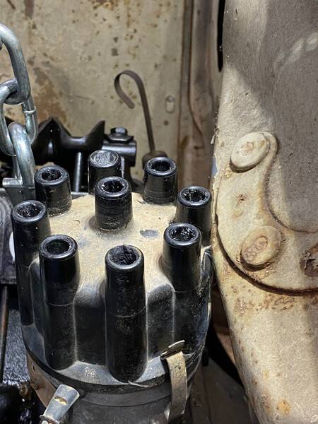

Here is a picture of a V8 on its new mounts sitting in a '63 notice how the wiper motor bulge leaves no room .

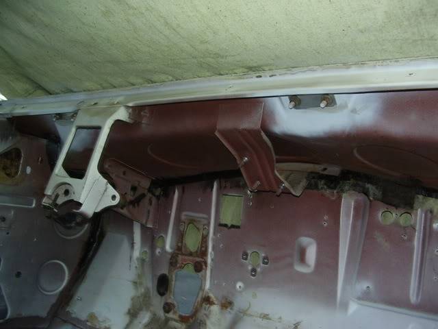

This is a picture of the inside of the '64-'66 firewall and wiper mount note the bump on the center of the firewall this gives the Distributor the clearance .
