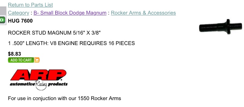

I’m think I would need to buy these type of studs to use that pedestal valve spring compressor tool, just got to figure out the thread size on the rocker bolt
I think it would be this 5/16x3/8 and I can use that compressor tool easy

A regular old screw type spring compressor from the part store should work.
Duralast Valve Spring Compressor
