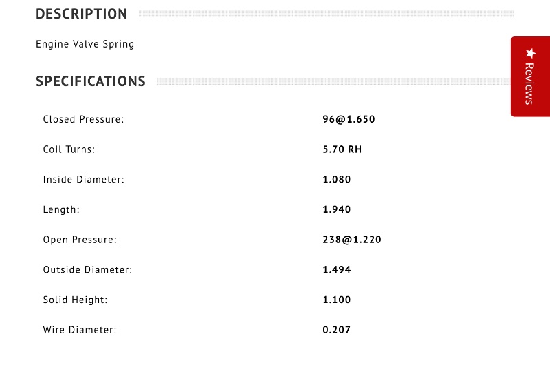

What valve springs....?

Okay to confirm the valve springs I used, along with the Hughes locks and retainers kit these are part number
ERV901
