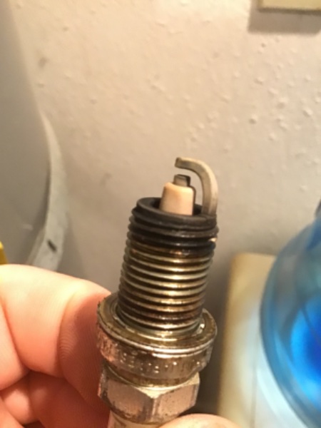

Plugs I know I’m running rich at start up I have no choke set up, there’s some oil from a valve cover leak I had
That plug is on the hot side for me. If you are running a timing curve you can increase the initial and reduce the total some.
If it’s locked out you need to pull some timing out of it ASSuming pump gas.

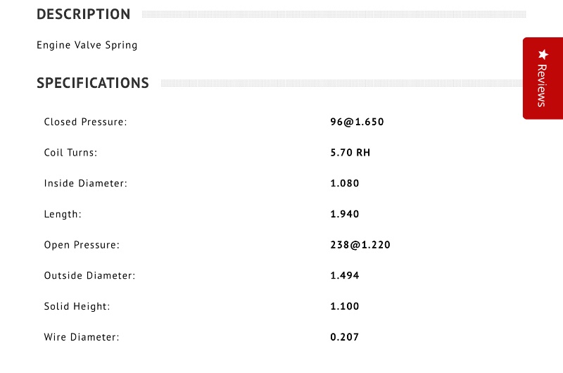

@MOPAROFFICIAL let’s say I have the wrong valve springs and I am getting valve float. Can you point me into the right direction for springs pressure rating?
Reground specs are
218/224@.050 .478 on both intake and exhaust installed 4 degrees advanced on a 106
The 901 is stock 340 cam spring and
won't work.
What installed height are you at?
1.64 or so?
I like to use 145 lbs or so on the seat and around 300-360 open for up to .500-.550 lift hyd rollers turning 5500-6000 rpm.
Stock reground core?
Yours shouldnt need more than 300-330lbs open.

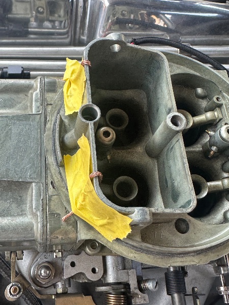

Did you know you can pull them out and thread the holes for replaceable air bleeds. We did that to this 500 2bbl on this Omni to get the air fuel ratio correct. Most speed shops have different sizes in stock.

Okay, so I guess there’s my issue. Not sure on installed height. I just had bought Hughes locks and retainers and those 901 springs and gave them to the machine shop to slap them together. So I’m probably going to have to pull the heads it’s crazy that I been running the car like this for a while now.
Another question Hughes 1110 springs would be the cure for this? How much more lift would these handle just in case later down the road I install a hotter camshaft?
To my knowledge the Hughes Spring drops in at about the same installed height as those 901s are recommended to be installed at. They are a higher lift spring and would work a lot better than what you have. You don't have to remove the heads in order to change the springs. So don't worry about that. You can bring the Piston up to TDC on each cylinder and hook a leak down tester to it and pressurize the cylinder to hold the valves closed and then use a screw down type spring compressor to then remove the springs and swap the new ones in place.
Oh yea I’m well aware. I do it to all of the stock Holley main bodies that I use. This was a friends car and he didn’t want to get that deep in it just yet. He had a brawler 750 new in the box and we tossed that on it instead of drilling tapping more on this one.
